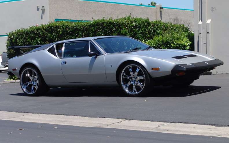

With my GT4 conversion looming, i'm considering the wheel options for my car. I saw an episode of 'Overhaul' last night where a Mustang had been prepared for a guy in a wheel chair. Great guy and great car, especially the rear wheels. They looked slightly 'hot rod' in size, but needless to say filled the wheel wells really well. The result was a fantastic overall look to the car.
It's got me thinking. Could you go 20" at the rear, possibly with modifications? The GT5 wheels would possibly have to be custom made. Who would make such a wheel?
This would break the mould in customising these cars and surely it create a certain look unprecedented in Panteras!

I chose the middle of the road, so to speak, I have the 17" x 11" on front and the 18" x 13" on the rear. I looked at the 19" and 20" rims, but when I looked at the cars that had them, I didn't like the way the curve of the fender followed the curve of the wheel. They didn't seem to go together, in fact I thought they looked like they had some one elses wheels on their car, if you know what I mean. I have seen several other types of sports cars that I thought looked great with the 19" and 20" rims and low profile tires.

Word! (I agree with you all) but I'm gonna take a stab at the 'new trend' and have the 20" and 19" wheels on order. I'll be sure to post pics when I get them and have the update done. By no means am I letting my 17" Cobra R's go though- that's my 'fall-back' to the traditional look as so many of you have mentioned prior.

Cyboman has a nice looking set of Kinesis K58 fr and K59 rears. I blieve he had to modify his rear sheetmetal to fit the 19's?
