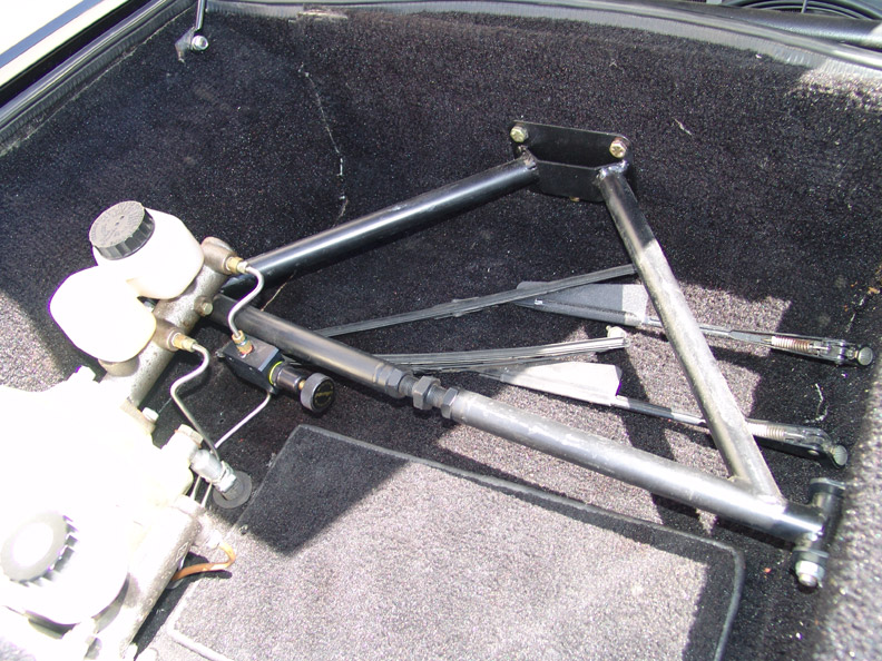

George,
I was talking to Larry Stock a while ago re bracing and he is of the same opinion as you that the OEM front tub construction provides adequate rigidity in that area.
Larry's (PPC, Reno) lower rigidity braces are in quite different than the other vendors, although not so popular (functionality, rather than aesthetics?). He runs them on his ORR car and swears by them.
The GP4 roll cage sounds like a good stiffening idea. I was taken with a 4 ponit one I saw that rather than go through the window was located behind it in the engine bay with tubes out to the rear inner fenders. The internal one seriously impact an already cramped space.
Here's a photo of PPC's braces and I'm gonna post another one of a slightly different novel thought on bracing. (I'm too stupid to be able to attach two photos in the same post)
Julian
  • PPC_Brace
I am aware of Larry's long brace that attaches beneath the passenger compartment. It is certainly trying to address the real problem, I'm just wondering how successful it is, due to the relatively small size of the tubing and the fact that it attaches with bolts, rather than welding. I would love to do some before & after measurements. Even if it cuts flex down by 1/3 it would be worth using it. Until I have data to confirm the usefulness of the brace, I don't feel comfortable recommending it. Again, let me state, it is at least adressing flex in the proper area of the car. I tend to like Larry's ideas. They show an understanding of the problem.
As to the engine compartment "struts" in the second picture, they may help stabilize the rear subframe a bit, as the tubing will be stronger than the fender panels, BUT they are attached to the roofline, which is a weak spot. The whole roof flexes, to the point that it cracks the windshield and breaks the A pillars off where they attach to the cowl area. Since the new struts flex less than the fender panels, they may actually increase the forces transmitted into the roof and A pillars, and make the buckling & cracking worse! I would not advise duplicating this design.
your friend on the DTBB
Originally posted by Joules5:Larry's (PPC, Reno) lower rigidity braces are in quite different than the other vendors, although not so popular (functionality, rather than aesthetics?). He runs them on his ORR car and swears by them.Julian
I'm having trouble visualizing how the Larry Stock Braces in the photo are installed. How and where do they attach to the body?

Larry's (PPC, Reno) lower rigidity braces are in quite different than the other vendors, although not so popular (functionality, rather than aesthetics?). He runs them on his ORR car and swears by them. Julian
Jeff,
The rear attaches each side to the three motor mount bolts on the chassis and then to the rear body. It requires drilling & bolting (removable for oil pan access) or welding in place. I believe the front requires all new holes drilled & bolting or preferably welding in place. The photo wasn't that good; if you have a real interest I could run down to Larry's with the camera, he's only two buildings down from where I work. If there's a potential sale in it, I'm sure he won't object.

I would say you received good advice Dan. As a side note: the large cross brace sold by Larry Stock is designed to tie the front frame rails to the rears, just as suggested by the chassis builder you had consulted.
