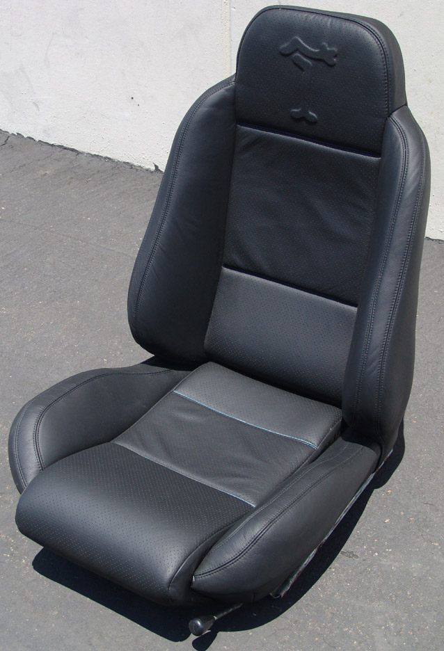

Just saw these. Probably an old posting but these are the Fiero seats.
http://www.detomasoregistry.or...s4Sale/KelmSeats.asp
Incidentally I think once you try the 8 way power seats in a Pantera, you'll love them and wonder how you ever survived without them before.
I didn't try them and I don't think they would fit too well, but the Taurus SHO seats with the power adjustable side bolsters might work for you too?
Mine are worn on the drivers side from climbing in and out, but they do keep you in place and you can really snug them up on yourself.
  • Fiero_Seats_for_Pantera
