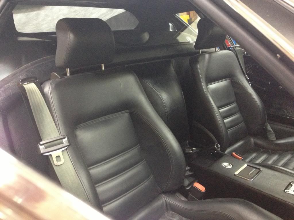

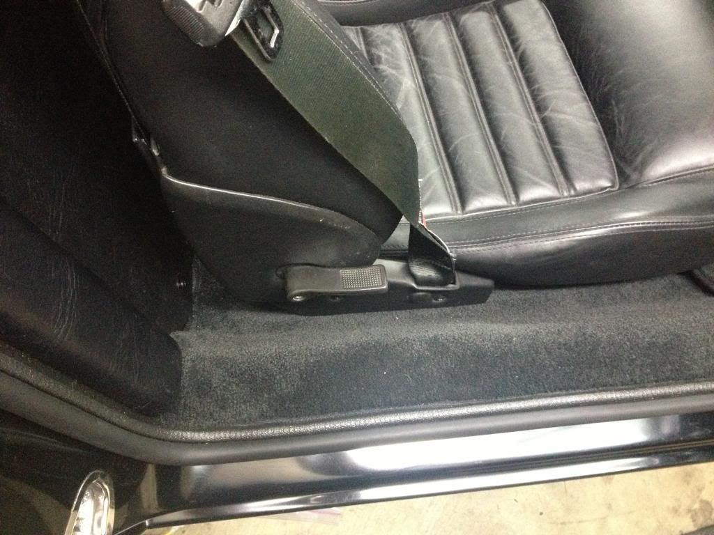

Glad you like my seats
![Big Grin](/static/images/graemlins/icon_biggrin.gif)
The picture is my car, it was taken when it was owned by Terry Morofsky. I think I'm a bit taller, so I had to do a lot:
quote:I had to remove roll bar, some of carpet, some of seat cushion, spacers, cut and reweld all handles on the seat (tilt forward and move forward), cut off one of the wheels that adjust the recline (the inner), move the handbrake ½" inwards and reinvent a cover. And am I now more comfortable than before? No
Let me be more precise on why I did the various modifications:
-Due to my size: the roll bar, the seat cushion, the carpet
-Due to wanting ICE ignition box mounted on left of console and wanting a proper cover for the handbrake: inner wheel was cut off both seats. So left seat inner wheel could have been saved. Outer wheels are there still and work
-Due to not functioning handles for fore/aft movement and release of seat back: Both were so low they dug into the carpet and you couldn't get your fingers beneath them, had to use a screwdriver, so I cut and rewelded in another angle.
Now everything works, but it took a long time. Would I, knowing what I know today, buy these seats if the car had had orig seats? No. But if you have tons of money and time and need a challenge, go for it...
![Wink](/static/images/graemlins/icon_wink.gif)
Anything more you want to know, let me know?
I used the original sliders. I order to line up the threads on the underside of the seats I had to drill new holes in one slider and fab and weld a bracked to the side of the other - that moved them outward by about an inch. No clearence problems with the handbrake box and they move freely all the way back - and forth.
I'm 188 cm (6'15")and still have about 2" clearence to the roof.
Not too good a picture of the pass side seat installed.

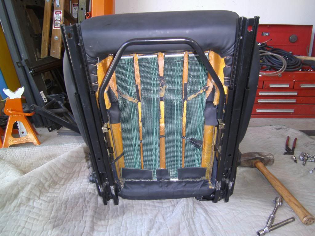

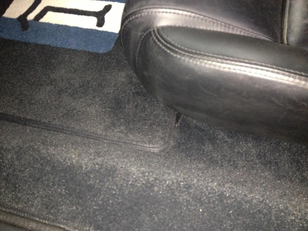

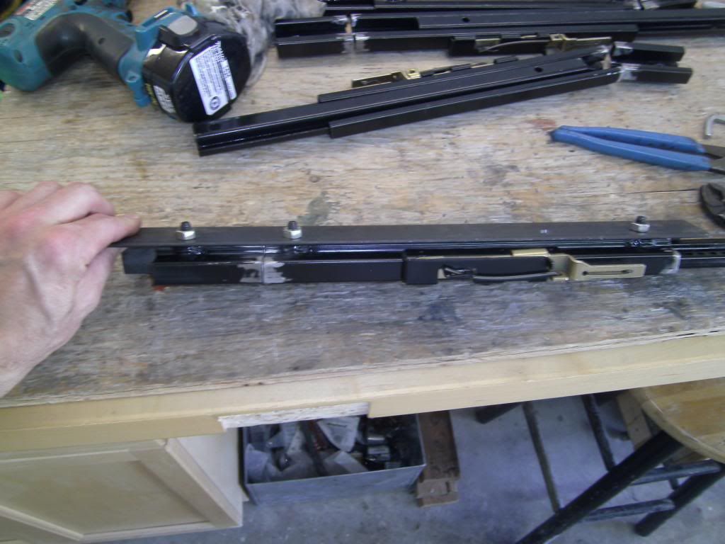

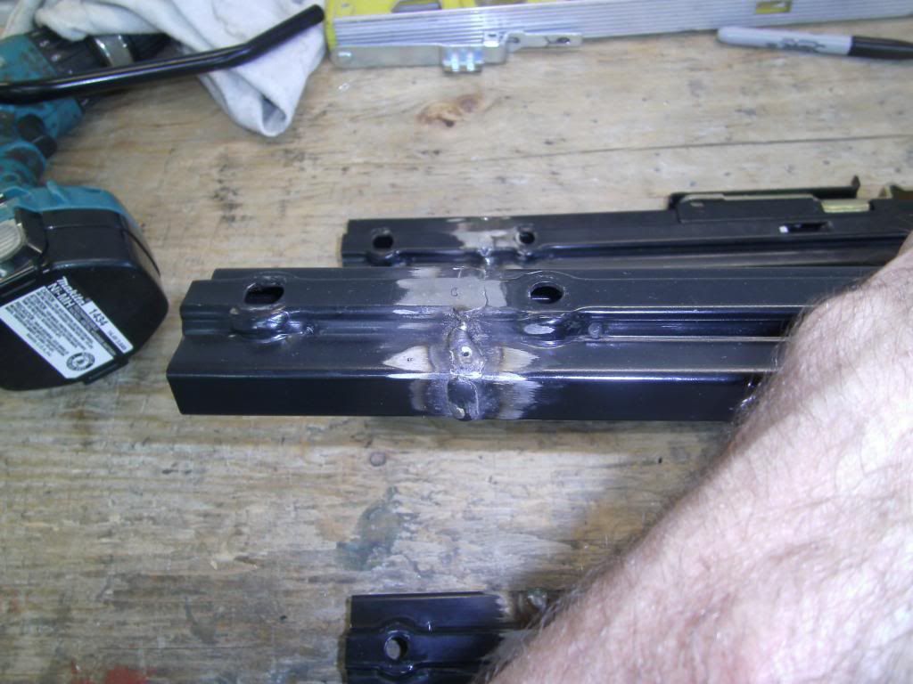

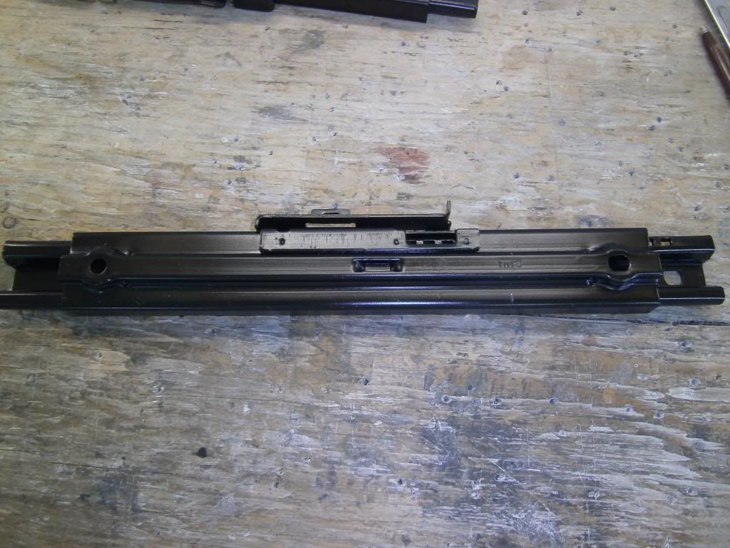

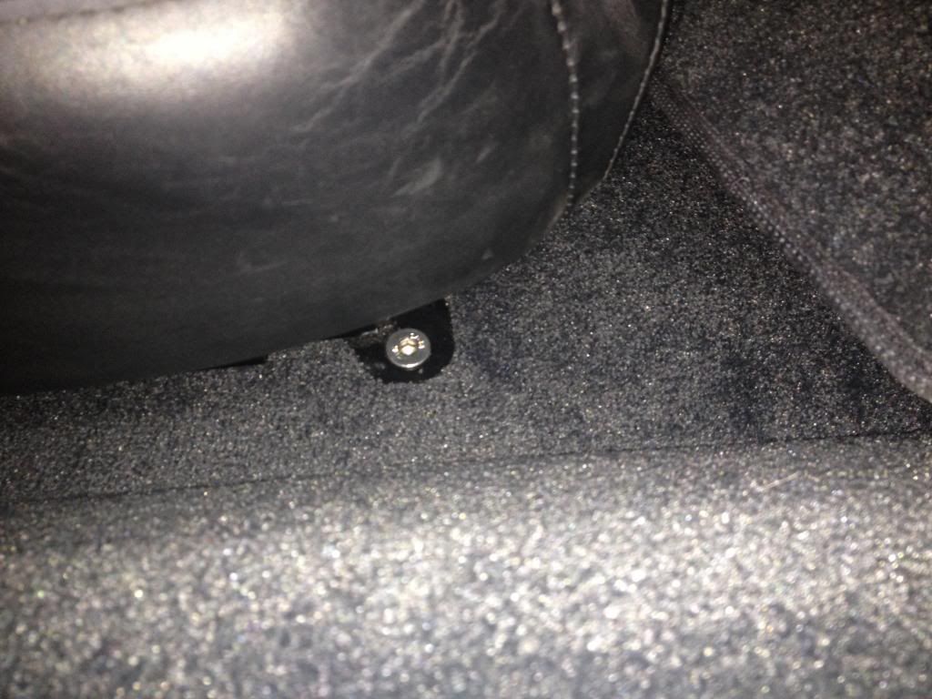

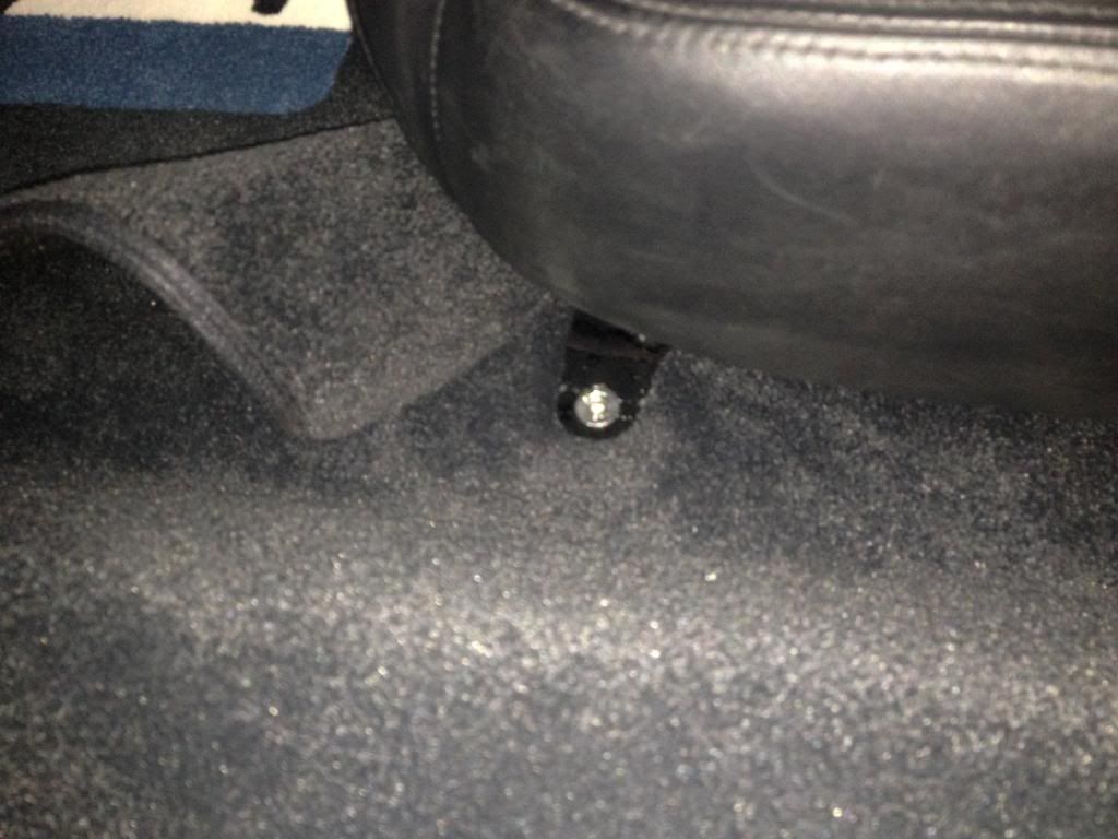

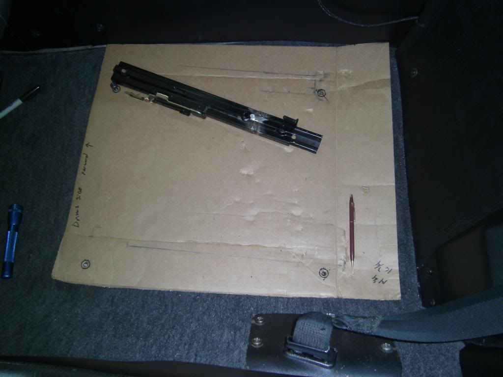

I first discovered the Ferrari 355 Spider seats on this thread on page 5 (I think). Like many of you I had been searching for seats that were comfortable and fit the car. These seats are by far the best I found. Most are too big or sit too high for a car with stock floor pans but these are a very close fit. The seatbelts are integrated into the seats so I was able to cover the holes in the rockers and ordered my bulkhead reduction kit without provisions for the rear seatbelt retractors. It makes for a clean look.
I wanted to keep the ability to slide the seats back and forth so sliders were required. The Ferrari sliders are powered and I didn't see the point so I saved some money knowing whatever I used would require modifing. Sparco double locking sliders seem to be the best option. I bought 3 sets of sliders because I needed extra material to extend them. In speaking with Dennis Quella he recommended angling the seats slightly inward towards the pedals and foot well on the passenger side to make the car more comfortable. After sitting in the seats and moving them around in the car I opted to try angling them. It's hardly noticeable but it does make a difference.
Here's a look at the process:
I had to cut out the factory spacers to lower the sliders as much as possible.
I had to use flat top countersunk allen bolts to clear the sliders.
