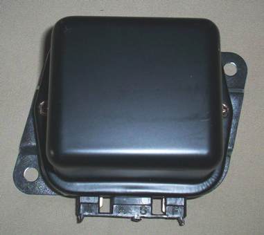

Well on my DOES 200 Group 4, it does seem I am not getting charge. Before starting the car I have about 12.5 V testing at the battery, and then after running I am only at about 11.8 V with the car running. Then put da wife to work to measure the voltage while I reved the engine, but no improvement. I cleaned the terminals and wires at the battery too. Belts seemed a little slack too, so I tightened them at the alternator bolt adjustment, but no improvmement. Any suggestions for further testing? I turned on the AC, radio and lights too and watched the amp meeter on the car dash and it was in the negative and reved the engine but no movement toward positive.

Thanks Dave. So with only 11.8 volt at the battery terminals with the car running and the generator light showing on the speedo, you think it could be the voltage regulator? I was just going to change out the alternator unless there is some other test I can do. I suppose to find the voltage regulator I just follow the wires from the alternator. Maybe I need to dig out the engines for dummies book and see what else to test.

Originally posted by DOES 200:
.....you think it could be the voltage regulator? I was just going to change out the alternator unless there is some other test I can do. I suppose to find the voltage regulator I just follow the wires from the alternator. Maybe I need to dig out the engines for dummies book and see what else to test.
John, I just turned the key to the on position and the generator light on the speedo does not light up. But start the car and it does light up.
Sounds like your charge light works OK. A voltage regulator change would be the first thing to do. $15 bucks at Pep Boys. They look like the picture below. Located on the right side firewall. Look for it from underneath the car.
Thanks guys. Is there a particular number that identifies that voltage regulator when I go to get the part? I was at Kragen today asking about an alternator and they insist on knowing what car it is, although I tell them to look up the 351 clevland, But no, they need to know the car so I says Pantera and of course "whats that, its not in our system" Roll Eyes
Thanks for all the help. What an easiest fix ever, swaped the old regulator for new and bada bing bada boom, freakin thing charged like a champ. Put da wife to work on the voltage meeter at the battery terminals while I reved the engine some and now got 14+ at the battery. Amp meeter on the dash danced way in the positive too, and no more lit gernator light on the speedo. Now to put back all the bulkhead that I took apart thinking I was going to change the alternator.
