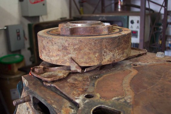

I have one here in the shop on which the outer ring has come completely off of. Fortunately the engine survived it.
I keep it around to remind me how dangerous the stock balancer on the original engine is.
