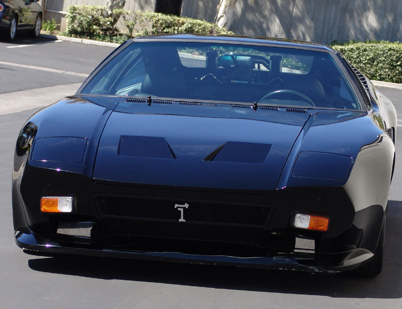

I may also be interested in a set for a GT5S. The GT5S uses a standard Pantera tail light, with an amber turn signal. The front signals, however, are smaller than Pantera Pre-L lights and have amber/white lenses (pictured below). These two color "European" lenses can also be used on GT5 models, and I have seen some L-models with amber/white lenses. Is there a possibility that you might make an LED conversion for amber/white front lenses?
Thanks, Paul

There are two bulbs located behind the two-color lens. The inboard bulb is 5 watts, and acts as a running light. This bulb illuminates the clear section of lens anytime the lights are on. The outboard bulb is 21 watts and acts as a turn indicator. This bulb flashes behind the amber section of lens when the turn signal is activated - it does not illuminate at any other time. The photos below show the turn signal on the drivers side.
The car in my earlier post is not mine - I pulled that picture off of the Internet. My car is pictured below, #9473.
I hope this information helps, Paul
Hi Paul, The pictures are helpful. The lenses and housings are not the same in size or configuration so the standard LED conversion that I provide will not fit. If you wanted to pursue a custom design I could do that. I am presently working on a custom design for taillights and side markers, so it not an unreasonable task for a LED conversion.
