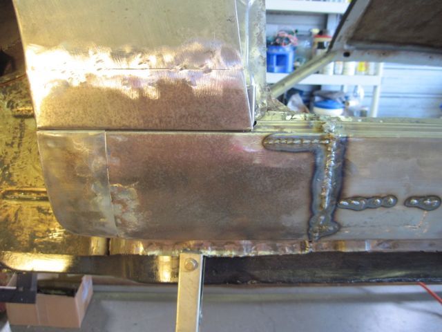

Now I need to rebuild the bottom of the A pillar itself. I chose to use a simple wedge shaped structure. This will restore the original strength, but was also a minor goof up, as I’ll describe in a bit:
I find that the contour filler panel and fender are rust damaged up a little higher than I thought, so another 1/2 inch or so has to come off:
Here I test fit a piece of metal to repair the outer rocker; making sure it will mate up with the work I’ve done so far:
Now to weld in the A pillar repair:
Here is just a small leveling piece. At the factory they just pinched the rocker flange in here and spot welded the snot out of it. This area was very uneven, so it will help to have a clean flat piece to weld on:
Here is what I meant by a minor goof up. That steel rod you see at right center is laid in the door sill; it helps me line up things. In the previous pic, you can see that it misses the A pillar repair piece by a 1/4 inch or so. That part of the outer rocker that forms the door sill, continues forward to form the flange where the rocker and fender panel join. It should also be tack welded to the A pillar for support. Oops. Likewise, the bottom of the contour fill panel extends down to the same flange, and lays flat against the A pillar. Oops. I need to add a piece to bring the A pillar out further here. It is mostly cosmetic, so a light piece should do:
Next I’ll add a backer strip behind where the original metal and new metal join. This helps two ways. In many places, it is not necessary to weld a full bead along a junction like this; a good spot weld every 1/2 inch or so is enough. I also do not have to trim the edges so perfectly. When I’m done with the metal work, I’ll back fill this junction with epoxy, and she’ll be good as new.
Now I use the steel rod again to position the piece of the door sill I cut out earlier, and weld it back in:

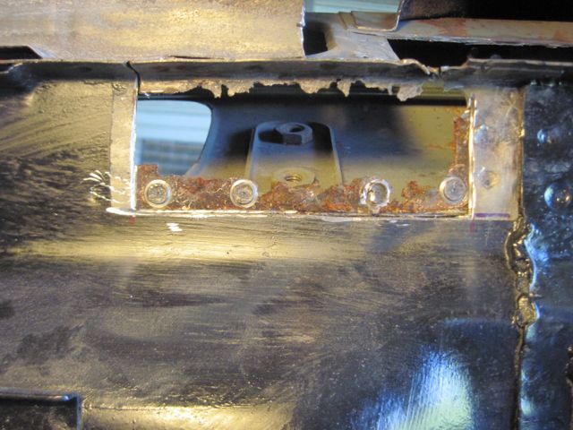

OK, now on to rust repairs to the bottom of the left B-pillar. First I strip away old paint, bondo, and some lead, so I can see the extent of the damage. At least that which can be seen from outside:
I’ll use some masking tape to section off the damaged parts, with attention to locate the spot welds and drains:
I may be able to save some of this outer rocker panel piece, but not what I find under it:
Now I have scuffed off the worst of the rust scale. I find what seems to be a good place to cut away the bottom of the B pillar:
This WAS 16 gauge steel:
So was this - the mid rocker:
Notice here the mid rocker is made in sections. I did not know this, and just happened to uncover a place where the lap weld is. Good to see the rust is only behind the B pillar.
This is the floor pan, just under and forward of where I am working. I spotted this damage earlier, and painted around it, knowing I would have to cut it out:
Cutting this away reveals the flange of the inner rocker rusted away too. I had to cut this out a little bit beyond what can be seen in this picture, to get back to solid metal.
I made a repair piece and welded it in, but did not get a picture of it.
Next to weld in a piece of 22 gauge to fill in the floor pan here.
Now I have all the rust cut out, and some of the pieces replaced. I mask the edges where I know I have more welding to do. Then I spray zinc primer inside, as I will not be able to it after this next patch:
This patch of 16 gauge steel was not too hard to make:

This area was badly rusted out, and after taking it apart, it is easy to see why. I’ve cut away the top part of the outer rocker here (what was left of it). It used to extend all the way back to the B pillar, where just a notch was cut out of it, and it continued rearward. The door striker cosmetic panel was curved down and forward, lapped over, and welded to the rocker / door sill about where my cut line is in these photos. This formed a wedge shaped little cavity just perfect for trapping all sorts of dirt, trash and water in there.
The masking tape helps me rough out the shape of the patch needed:
Here is the rough cut:
After some trimming and contouring:
I decided to use backer strips on this one, so I do not have to get it so perfect:
Test fitting looks good so far:
Clamping it in place to be sure it fits up right:
Next I have to make up pieces to patch the quarter panel and the top flange of the outer rocker:
The bottom of the outer rocker piece had some rust through holes too, so I made a patch for it:
Here I am just test fitting the repaired piece:
And the other repair pieces are taking shape:
More test fitting:
I flanged the top of this piece:
This little piece is needed to fill in a gap:
One last test fit with all the pieces in place:
Now to start welding:
One of the challenging questions is which piece to do last. It is easy to paint yourself into a corner, so to speak:
I do not have a pic of the repair after clean up. I’ll try to remember to take one. It looks better than this.
Tune in again for my next episode; the infamous rear wheel house repairs!

If your doing that kind of work to the doors, it wouldn't hurt to put the door on and check fit. I cut the door jam on mine and pulled it out fitting new metal to make the doors fit better:
I also welded music wire to the fender to tighten the gap making a real nice fit:
Yes, I will be doing that; thanks for posting your work on this. I remember reading it at the time.
I'm waiting on a new set of striker - receivers, so I will get back to this task when they arrive. I also had to buy new doors; mine were rusted beyond saving, so I will have quite a lot of "fitting" to do.
Question for you - did yours fit this badly? I remember this area was heavily leaded up when I took it apart.
