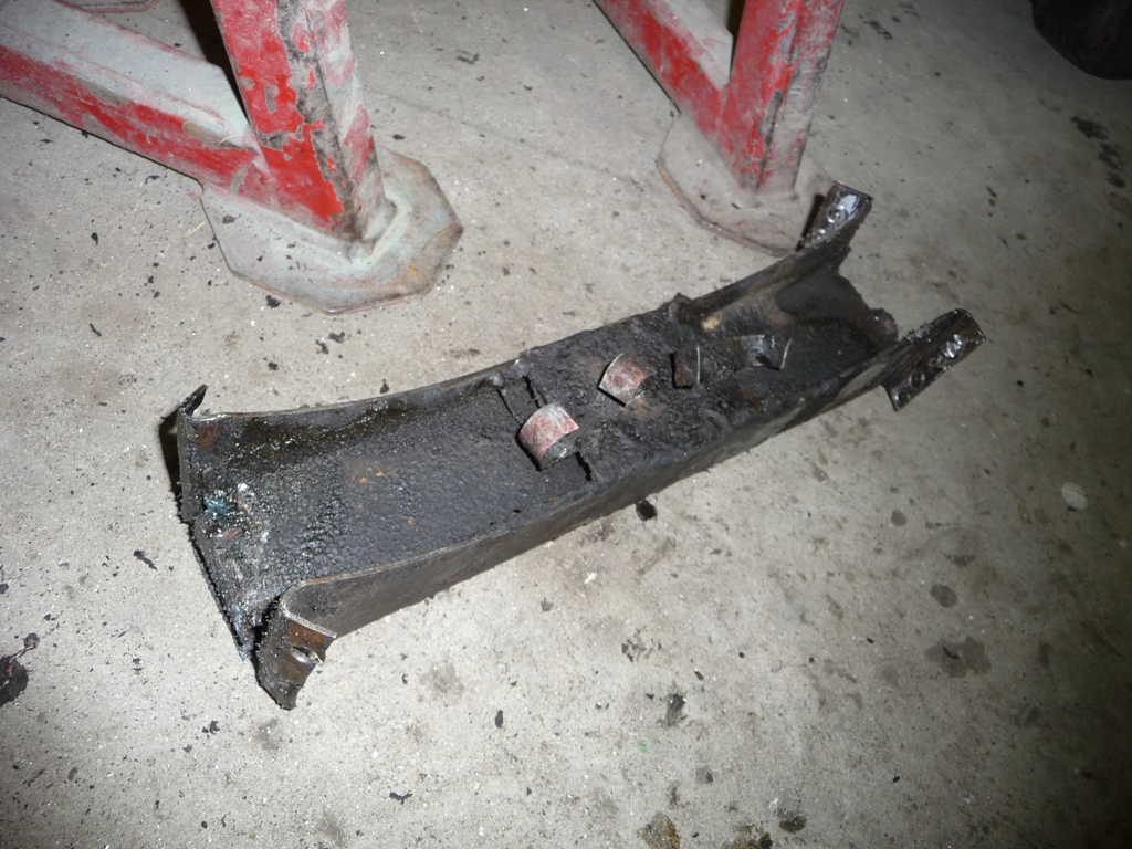

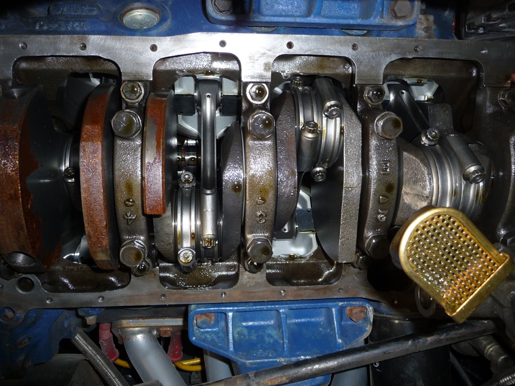

When I had the engine built we noticed a thumping noise coming from the oil pan. We thought it was from the larger crank hitting the oil pan. Maybe it is something more serious.
Hi Robert,
Thanks for chiming in with this. I too heard the odd noise, and you tip resulted in me putting up on the hoist and pushing on the bottom of the pan. Sure enough....the noise changes and I can feel the crank hitting the pan. It looks like someone tried to make clearance with a hammer...but wasn't exactly successful. Thanks again.
Anyone got an aftermarket deep pan they want to unload...
quote:Originally posted by Rob Borruso:
...someone tried to make clearance with a hammer...but wasn't exactly successful...
what if took a section of pipe, the diameter of the crank throw, and used it as a mandrel to form the pan's bottom.
a little heat to reduce chance of cracking and a wooden cradle cut for support
Yep....that should do the trick JFB.

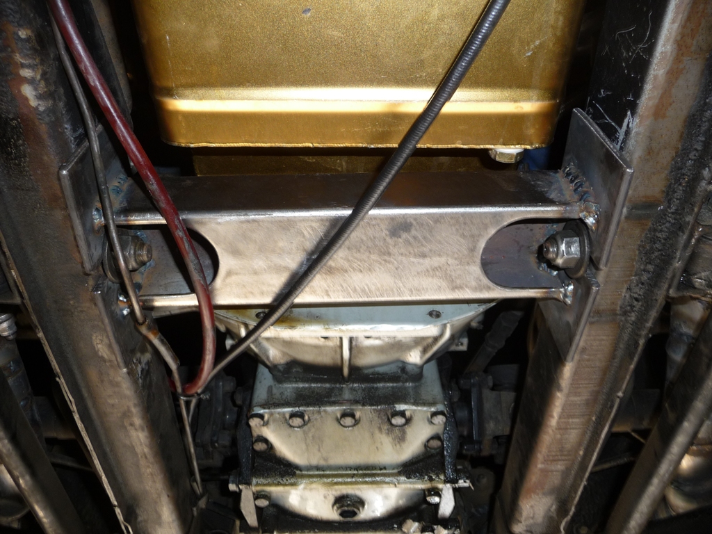

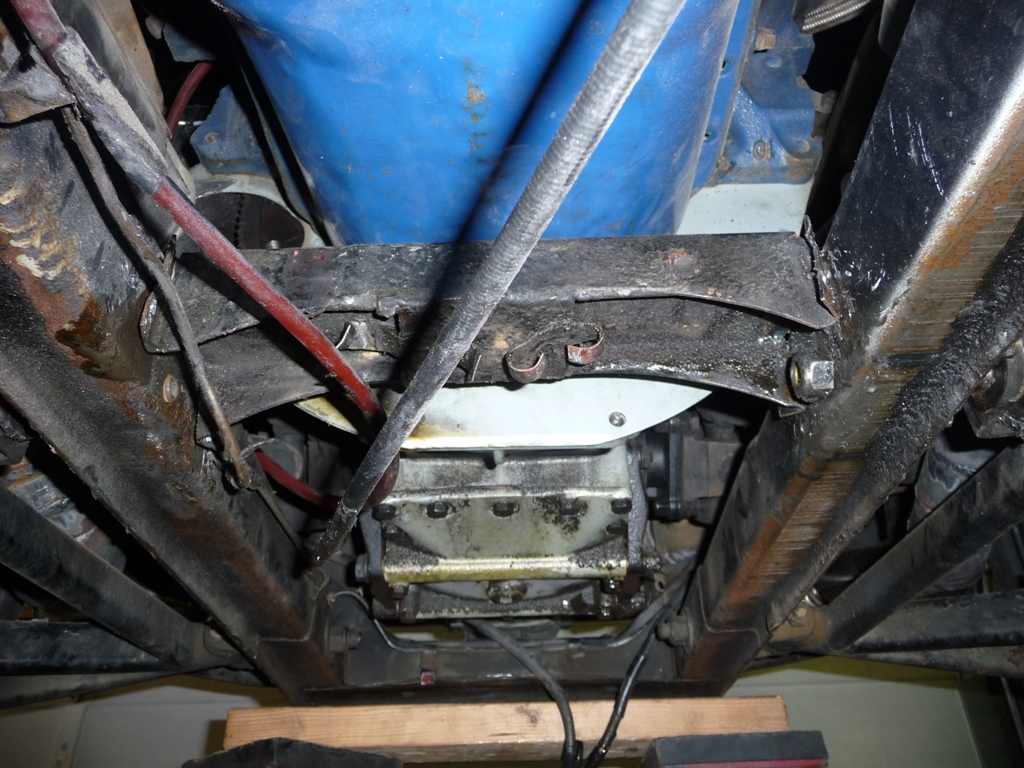

I purchased an NOS Milodon pan and pick up (they are no longer available... so got lucky). It is fully gated. I like the design and quality. Nice piece. However, in doing the install (you all know what's coming next... ;-) I didn't want to pull the engine, so fabricated a removable cross member.
I still need to trim the long ends which hand down below the frame, but ran out of time on the day of the project. I'll take care of that when she comes apart for restoration.
Since then.... well....still working on wearing out the tires
I have about 300 miles on her now (well...the odometer shows that, but don't forget about the previous sentence). Much of that was in drift...LOL. I really am enjoying her. She "tram lines" a bit on roads with heavy tire wells but think it has a lot to do with the existing wear on the front tires (don't forget..they are from 4042), I need to balance the front tires and will swap out the radiator for an aluminum one I have, to keep the temp on check..as she gets up around 230* in heavy traffic
. Other than than..all is good. She runs like a beast jacked up on a triple espresso... I love it...

Did you change the oil pump out as well?
How's the oil pressure?
Sounds like you are having a blast.
Rocky
Rocky
Hi Rocky,
Nope, didn't change the pump. Took it apart, it looked good inside...brand new looking in fact. So, I put on the aftermarket pick up, new pan, 50w oil....and put it back together. All seems good so far, even at 230*. So, think it was a combination of the original p/u and pan.
Yep total blast, self control seems to go out the window though...so just need to keep from getting arrested...

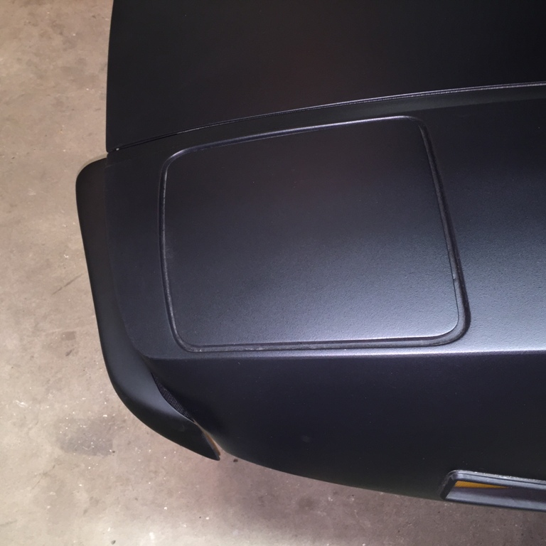

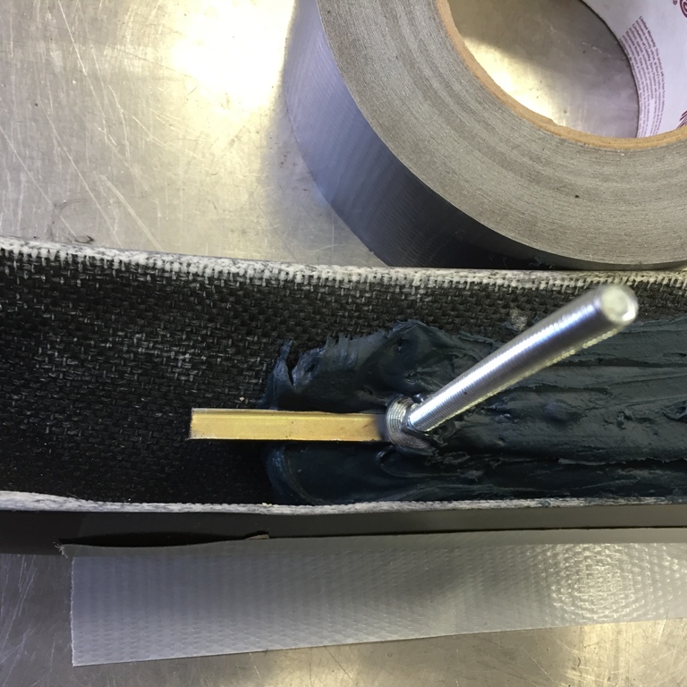

OK...so camping season is over...time to get crackin again...

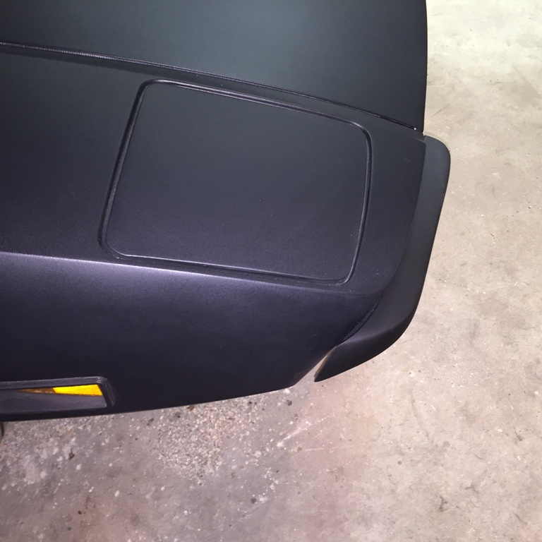

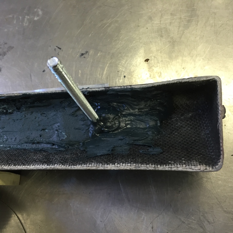

I decided she needed bumpers...so got in touch with Mr. McCall and picked up some fiberglass pieces for the front.
1) Do any shaping necessary before installing mounting bolts, so you can fit to the body contour.
2) Welded some 1/4-20 carriage bolts to a metal strip to keep them parallel to each other and glassed them in.
3) Paint..install
3) Paint..install
Looking good Rob. I like it!
Those look great rob.
Thanks guys. I finally got her out in the daylight today to get a better look at them.
Looks great. Smooth fit.

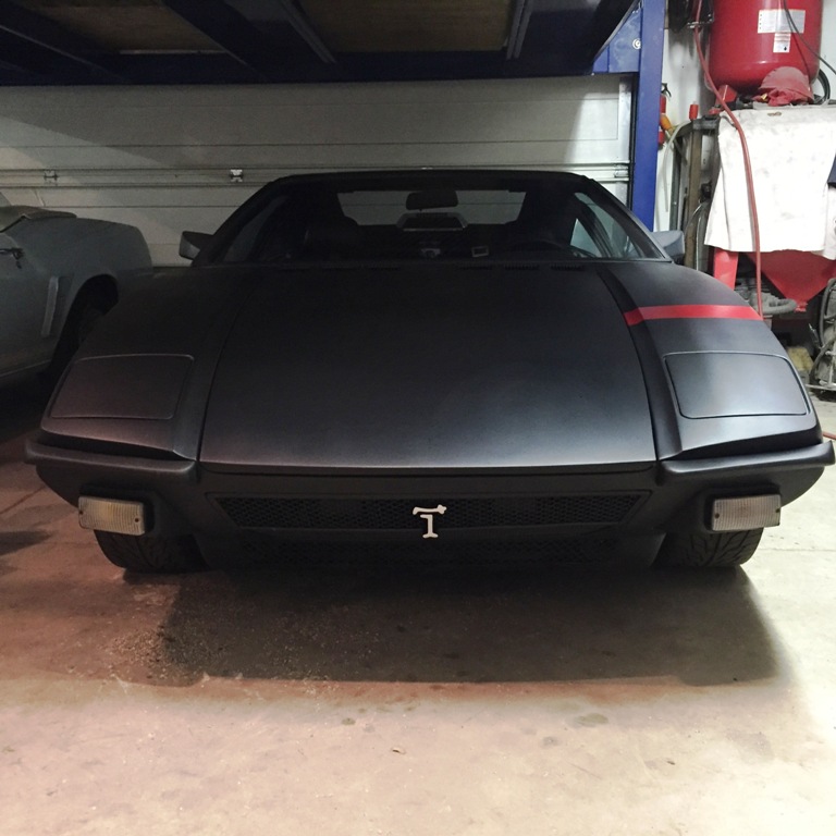

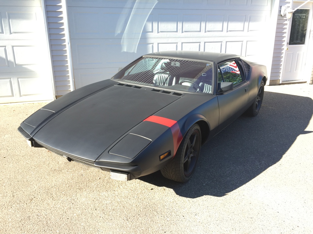

I'll go ahead an apoligize for asking a dumb question...
what is the significance of the red strip on the left fender?
JFB, I'll add a possibly dumb answer.
I'd heard of someone adding a similar stripe on a race car to differentiate it from other similar colored cars. (??) I fail to remember who it was attributed to however.
Hi guys,
Correct...the stripe...while it's just for fun..was intended to identify cars within a team (i.e. similar looking team colors).
Yep...similar look we're chasing there Larry.... :-)
