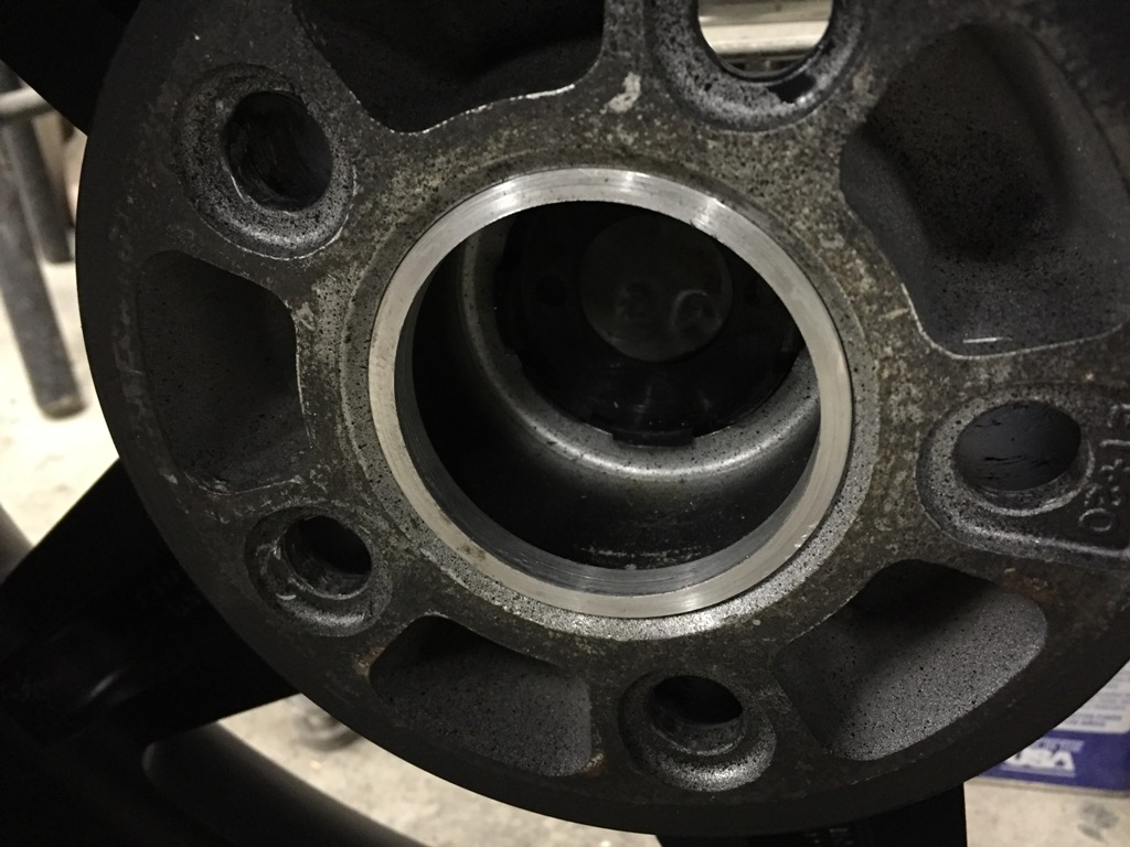

I machined up some spacers for the front hubs, so the wheels pilot to the hub and not the lugs. I didn't feel the need to space the wheel out any (like the rears)...so just made rings which are a snug fit to both mating pieces.
Hi Robert, Thanks for that info... no wonder she runs so strong!
what is your front/rear track with these wheels?
(and tire size)
(and tire size)
Hey JFB, The fronts are 235-40-17, the rears are 285-40-17. I haven't measured the track width..sorry. I can do so if you need it.

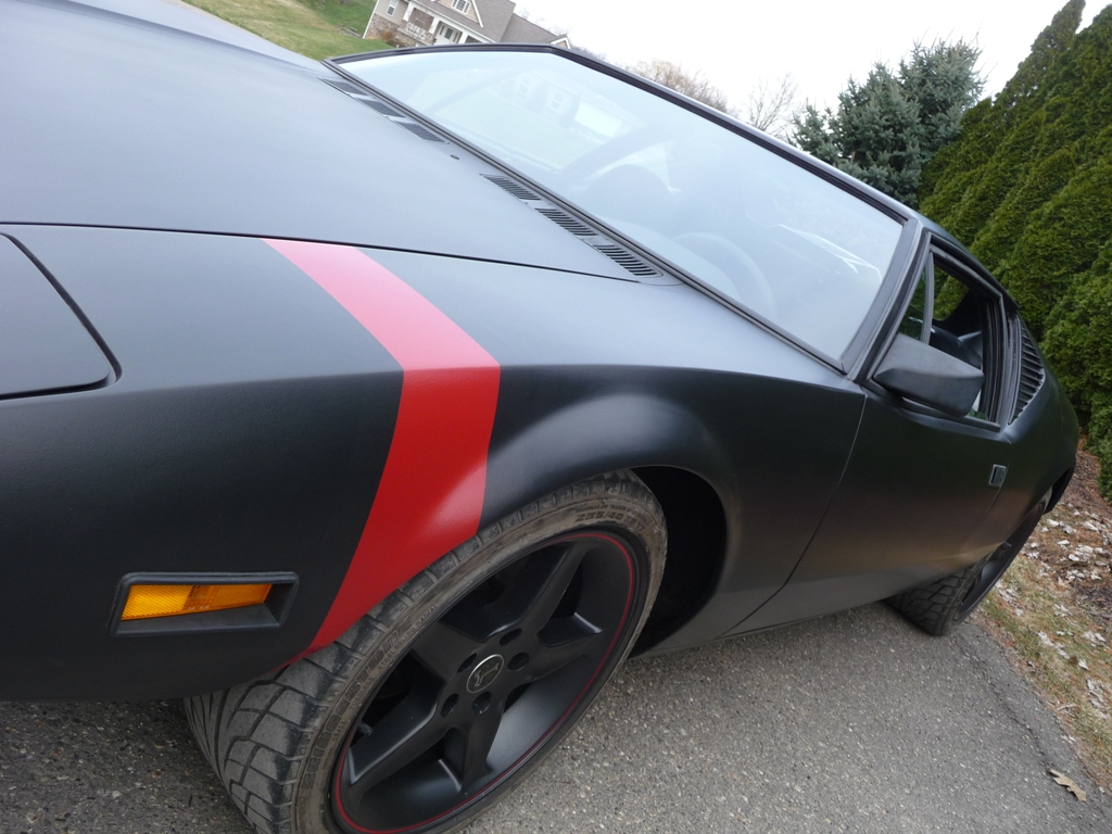

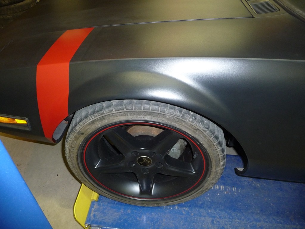

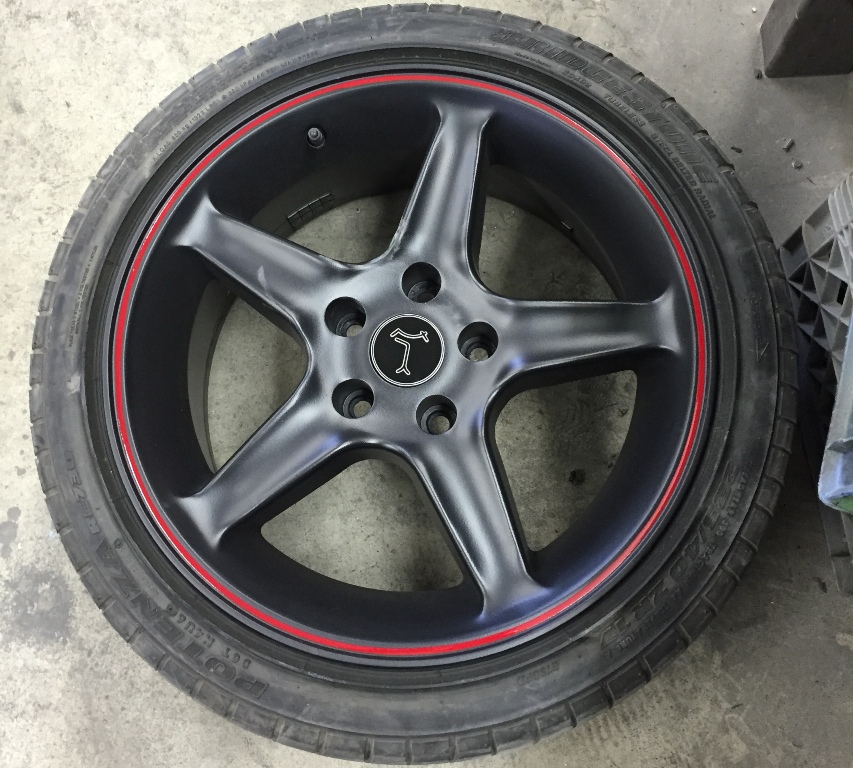

Started the day off doing some paint details. First I pin striped the wheels
Then I painted the stripe on the fender...

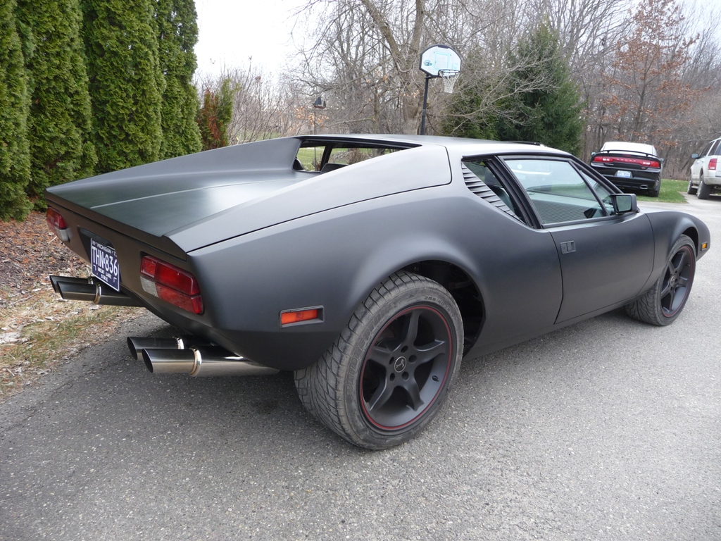

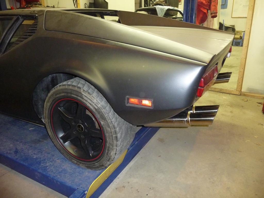

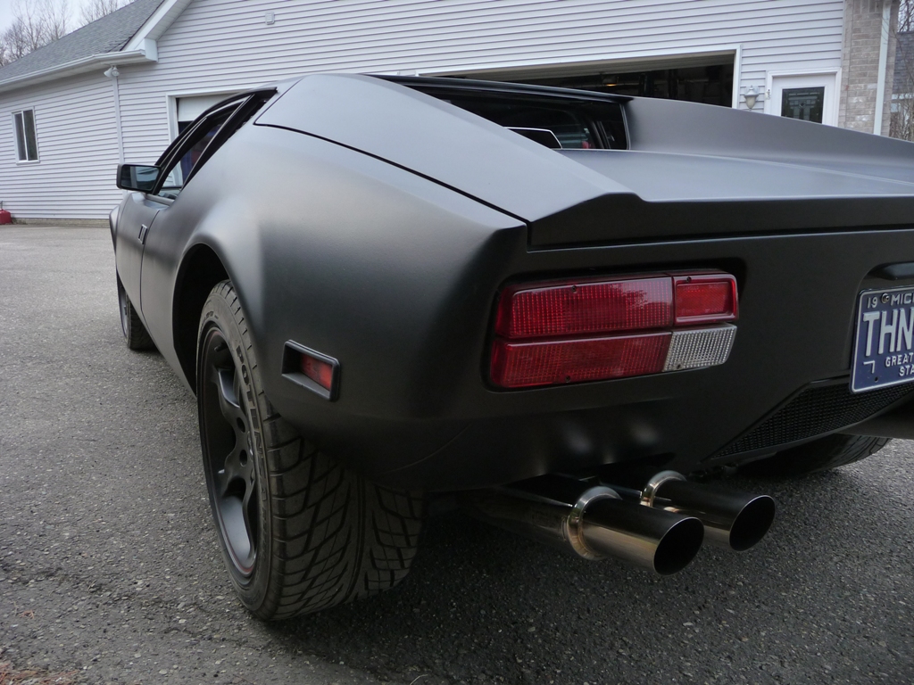

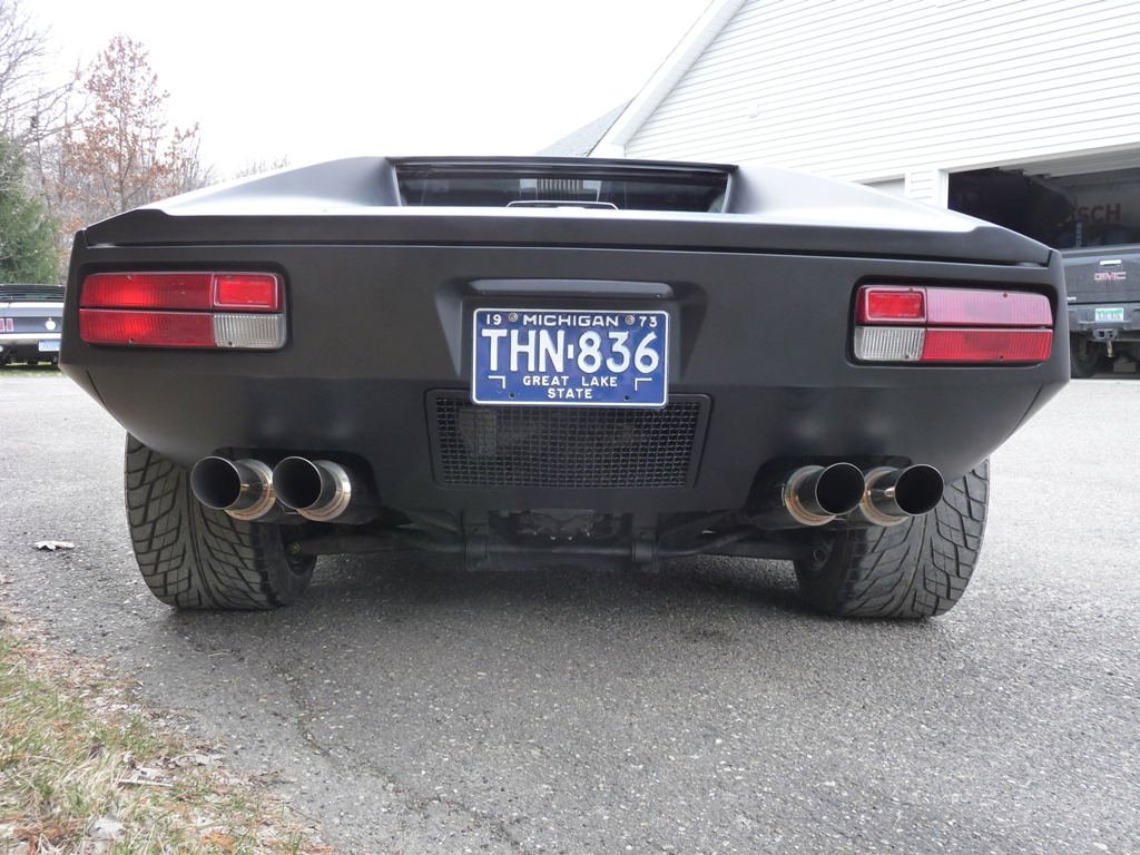

Then I spent the rest of the day/eve tackling the exhaust.
Sounds great..! The wife says the dishes rattle in the cabinets when I pull in the garage... PERFECT..!

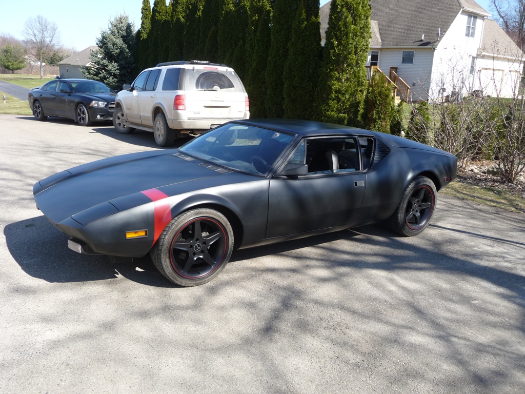

Out in the sun... put about 5 miles on the odo doing laps around my neighborhood on Sunday. I think she's about ready for an extended run out on the roads... Let's see if I can do so w/o getting arrested. (Yep..that would be good.)
Robert, Have not yet had to add brake fluid. A caliper leak is of course feasible...but I can't confirm, as I pulled the cals apart and cleaned em up. I haven't seen any evidence of leaks yet.
The clutch master was weeping when I picked her up. The trunk area under it was wet with brake fluid. I assumed I would have to rebuild the cylinder..but since I added fluid and bled the air...it hasn't leaked anymore.... magic. or...Aliens... whichever. Honestly, I have rebuilding the cylinder on the list of to dos...just to be certain.
quote:Originally posted by Rob Borruso:...run out on the roads... w/o getting arrested...
maybe add a tail/brake light kill switch
and a coat of water removable whitewash
I don't think you can "rig for silent run" though

JFB, I think with this exhaust, silent run is out of the question. But....what I didn't share with you guys is that I glued aluminum foil to the body before I painted it... she's invisible to radar!! Admittedly, I do like the water soluble paint idea though...hmmm... got me thinkin.

Rob -
I don't know if it's too late to change your stripe orientation, but I really like the orientation of a more diagonal one (behind the front wheel) that's on F.A.S.T.'s car.....
Check it out. Another option.
I like your stealth body color. That's cool.
PS> And I am sure that whether the stripe orientation pleases me is one of the key criteria of this build??
oooh Rocky... I agree that does look cool. It also could have had the Italian flag colors (looks like FAST's "may" be this way...not sure from the little avatar pic. Well... a bit late my friend... so you're just going to have to deal with it.. . That's what you get for coming late to the party....

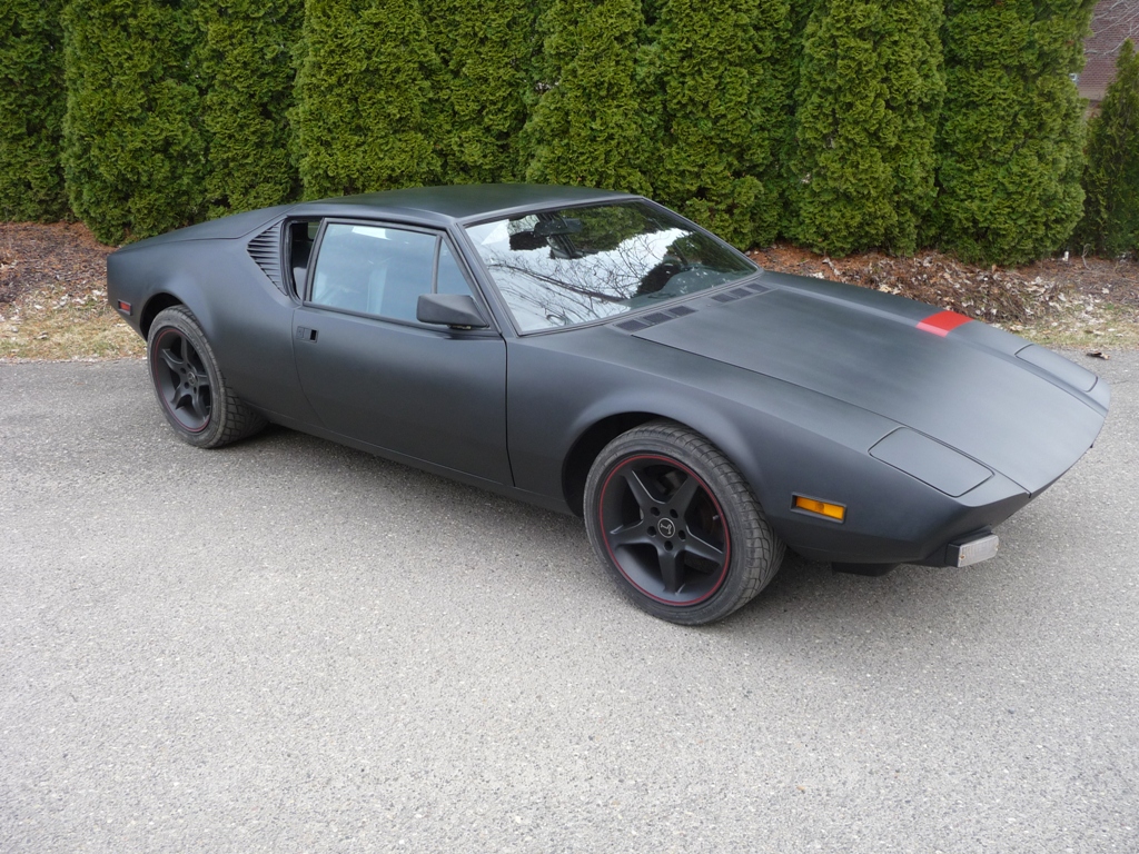

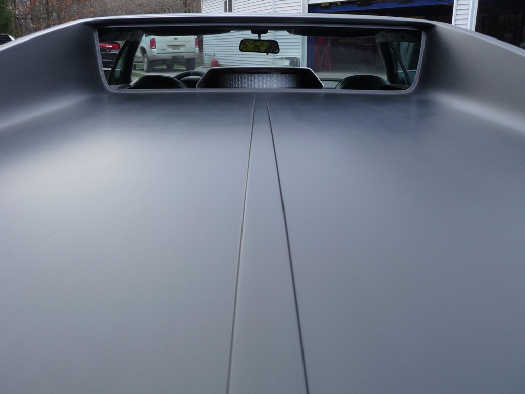

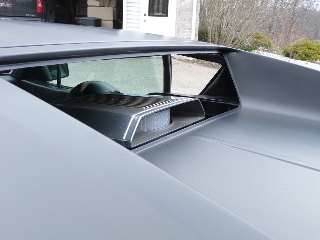

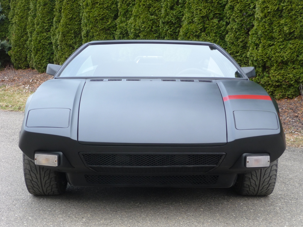

OK, so 6001 is ready to roll again. Thought I'd snap a few "ready to hit the road" shots...

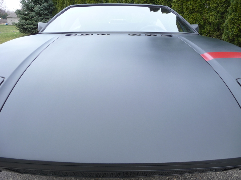

I'm glad to see the effort on the hood paid off. I'm pleased to see how it looks out in the light.
Now.....it time to wear out some tires.....

PURE PORN!
Very stealth. You need a driving suit to match? Maybe with a racing stripe on one sleeve?
I forgot what color you decided on here? Is this a pre-mixed "hot rod black" or did you have it matched to something?
Is that satin or is it flat?
Some are single stage, some use and activator?

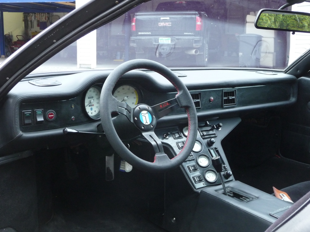

I like the steering wheel.
What brand and hub?

Simon, the wheel is an aftermarket Nardi Personal. Hub is an ebay piece...nothing special. If desired, I can look up the specifics.

I just get this distinct impression that it is completely invisible to radar? I wonder why?
Don't forget about the aluminum foil mentioned some posts back....
Funny enough, the camera can't focus on the car. I have to lock the focus on some area with sharp edges or on the ground nearby then point at the area to be photod.
I don't think I want to test any theories with the local sheriff though.
Looks fantastic Rob. Super smooth and mean.
WOW! That came out wild! I must admit I was skeptical when you started doing the matte primer finish. Seeing it in progress had me wondering what you were thinking - but putting it all together in a hyper clean minimalist look is striking. Great job!! Rod
