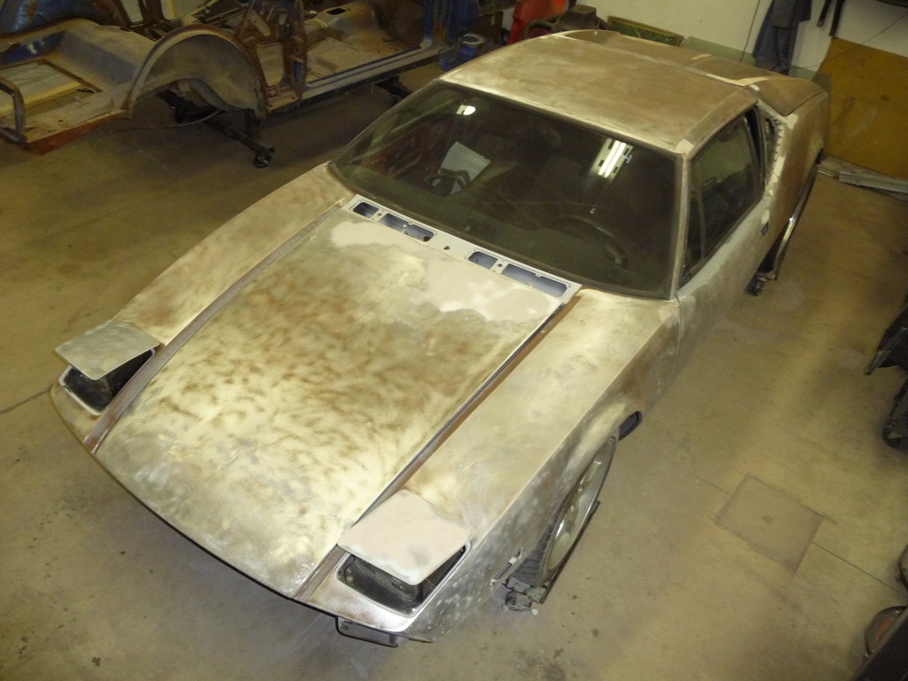

Summer is over...toys are put away...kids are back in school...time to get on a project. This winter I'm going to jump 6001 into the line up, as I'm getting a bit bummed I don't have a Pantera to actually drive. Since 4042 is quite a way away from driving condition, and 6001 is ugly...but very drive-able.....I'm going to do her body work and put her in black primer/sealer. I'll drive her with the flat black look until I finish 4042. Then...I'll put 6001 back into the shop for a proper restoration. So, this will ... I guess..be chapter 1 of 6001 restoration.
She's a solid car, with a stout motor, decent interior, nice set of wheels (though quite weathered and needing love), but the paint is quite bad. She was in grey primer when I purchased her as shown here.

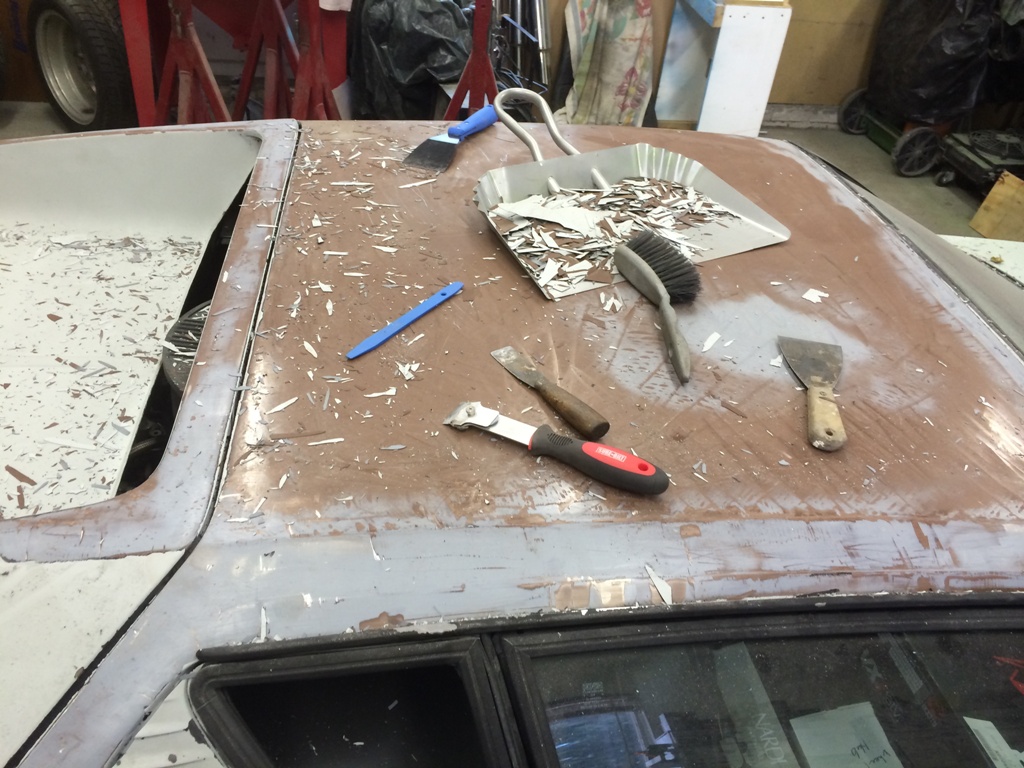

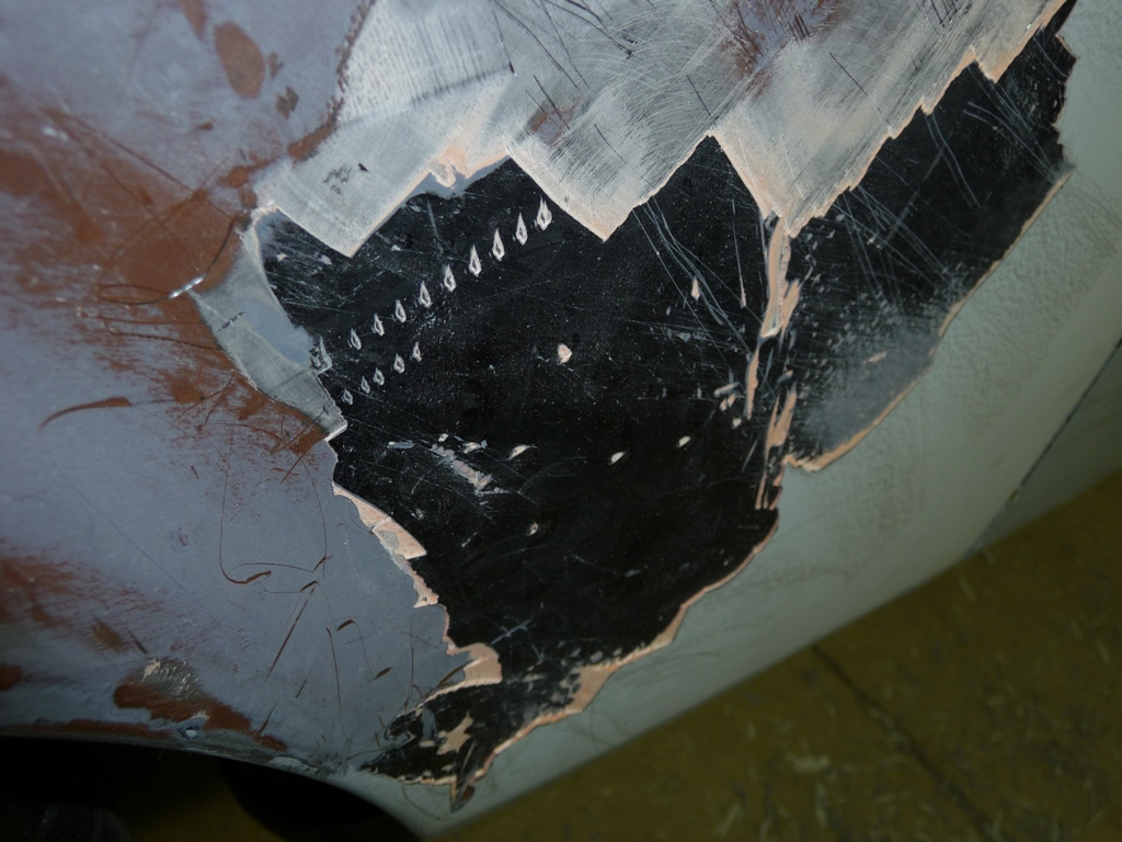

My minion and I have spent a few hours scraping paint off, and have found some interesting prep and paint work along the way..... The prep work was unbelievably terrible. There were areas we were able to separate the paint and primer and peel it off in big sections.
Found a section on the passenger door that had primer which was about an 1/8" thick. I didn't know it was possible to spray it so thick...???
Found one area where there was gloss paint under some body filler... Sweet
I think I've done as much scraping as is feasible at this point. Will start with the DA sander in the morning.
Thanks for posting...
I never knew one could use a putty knife to scrap paint off a body!
with the layers of bondo and extreme thick primer that defined the shape. are you going to do the body metal work back to desired finish during this "new paint only"

Well...actually...I didn't either. I had a local sand blast guy at the hose checking out 4042 last summer when I had the surface rust on it. While he was here I asked his opinion about having 6001 soda blasted. He told me I was welcome to bring it to his shop...but he would just scrape it, not blast it. I said "huh"..... and he proceeded to use one of my razor scrapers to demonstrate. I was amazed. As many cars as I have restored..and I never considered this method. I then bought a box of heavy duty single edge blades on Ebay and a heavy duty scraper handle and got to work. I have effectively stripped the car in about ~3 hours of collective time. There are still areas that I will have to go back and do with the sander...but this was way faster and I didn't have to run my compressor for 2 days to make it happen.
Yes, it appears I have uncovered some panel deformations (based on the bondo), and I will address those areas during this chapter of the restoration. Hopefully mostly with a hammer and dolly Wink rather than body filler.
I also have the front wheels. They came with it. I removed them to help with the turning radius moving it around the shop, as the tires are too large and they rub. For ease of getting her on the road for the spring 2016 target, I may just pop the Cobra Rs on her from 4042 (which are now on the fronts).

It MIGHT be "featherfil". That or a generic is what you need to use on fiberglass to get a smooth surface to work with.
It gets used with a hardener and is a mixture of epoxy primer and very fine body filler. Fine enough to spray it on.
This actually looks like body filler to me though?
Some body fender guys like to think of themselves as sculptors and skim coat almost everything.

Yes... I think I shed about 10lbs off of her already. The paint on the hood alone was probably 1/16" thick. The hood actually feels lighter now when I open it. It was so hard that I had to use an angle grinder to get it off. Unlike the scraping process...the hood took me half of Sunday....

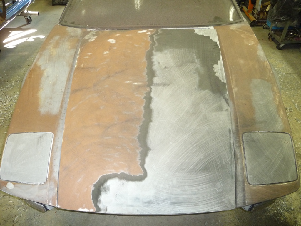

Anyway, got the hood done. Unfortunately it took longer than it should, as my compressor couldn't keep up. Seems I need to rebuild it. Can't really complain I guess, it's given me 13yrs of hard labor. Rebuild kit on order, should be here for the weekend. Only real down side is I will have to spend valuable garage time working on equipment rather then 6001. Mad errrgh
OK, so...compressor rebuilt and back to work. Boy...what a difference it makes to not have to keep stopping for air. With the slow performance degradation over the years, I had forgotten how well this thing worked when it was new...

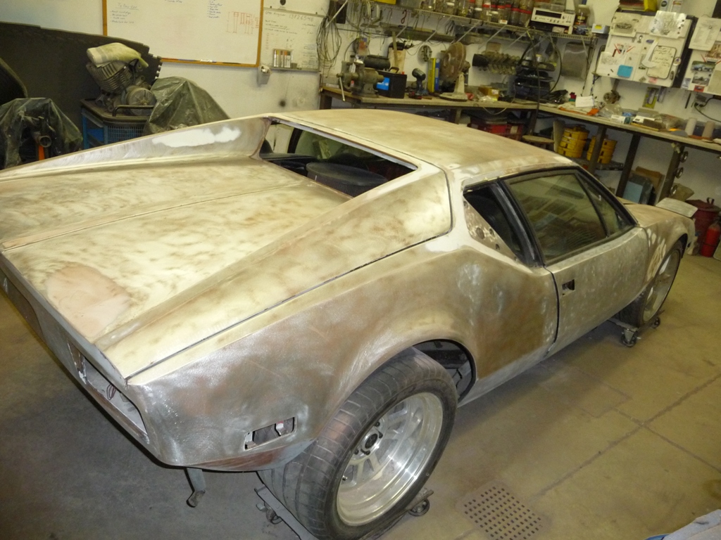

Spent today taking off more layers of paint and quite a bit of body filler. One of the primer and paint layers had to have bee catalyzed primer and enamel.. I had to use the grinder again to get through them. I really don't like doing that on such this panels, but think I managed it w/o getting into the metal much. The really good news, no rust found yet! However, there is body damage on every panel. I can only speculate that there is no rust because whenever the owner wanted to drive it, he had to first call the body shop and see if it was ready to be picked up yet from the last time he drove it. Therefore...not getting very many miles over the years..
Anyway, I'll take dents over rust any day of the week. There was what seemed to be a lot of unnecessary body filler in many places, so between the 4 layers of paint and a gallon of body filler...she should be a bit lighter when I'm done too.
It appears the color change was done professionally and at the same time the bumpers were shaved. The work after that looks like local bump shop quality work. There was none of the original red found, so the color change guy sanded it clean, even in all the nooks and crannies. All the subsequent paint jobs were black.

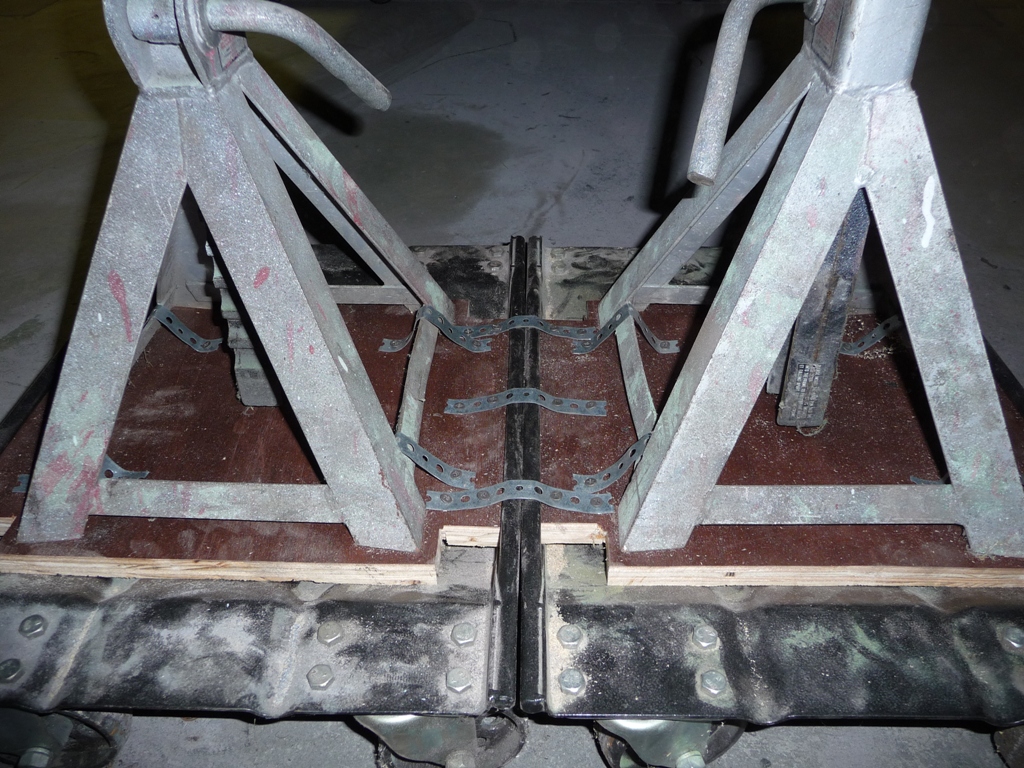

And, I think I have some serious garage space envy as well. I simply don't have the space at my place so 1424 is down at my (very awesome) mechanic's place getting things done. I'm in the process of acquiring space where I can build some serious garaging.

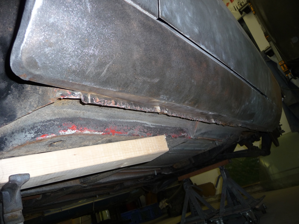

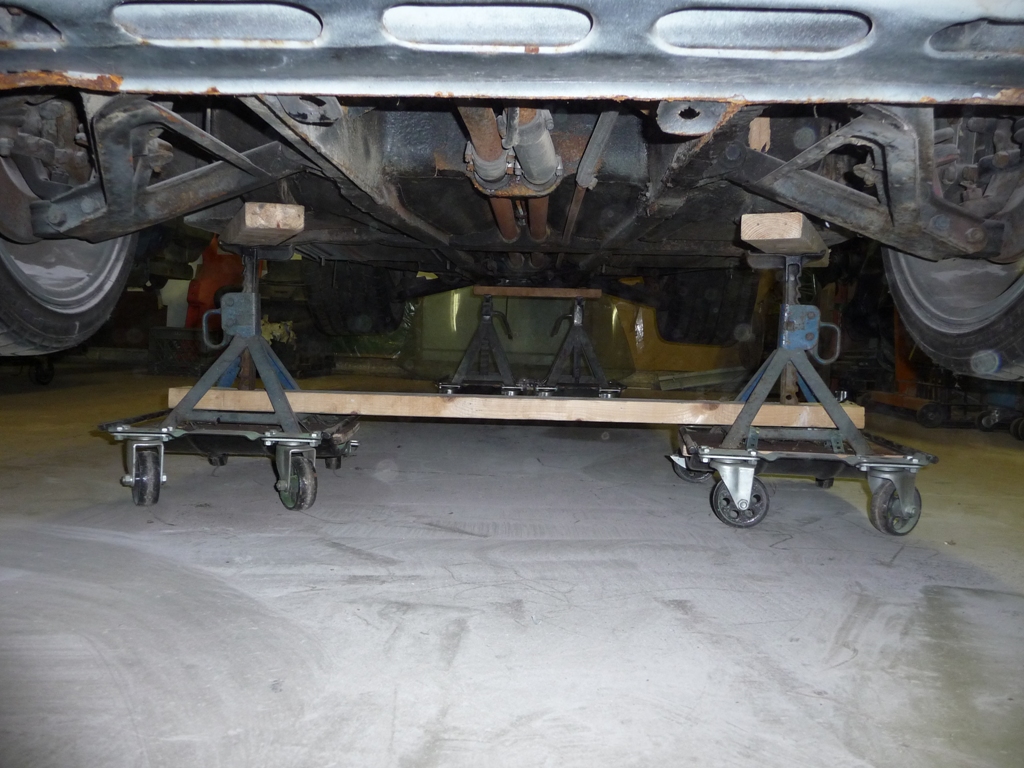

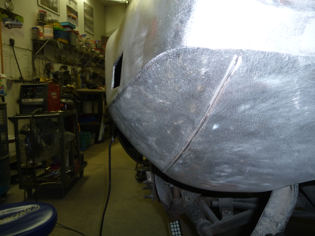

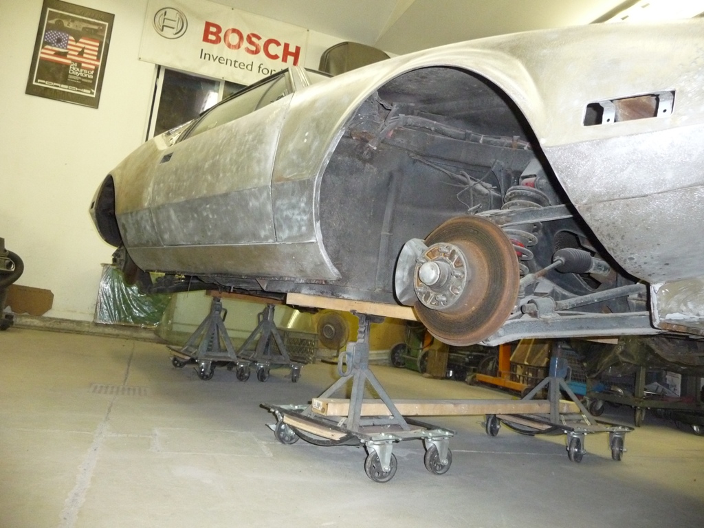

The rollie jack stands worked out great today. Was able to move her around as needed to get access and lighting to the lower & rocker panels. Got them all stripped and cleaned up today. I really have to say how lucky I feel...the rockers are spotless clean. The drip holes look great. The car gods are treating my kindly.. Big Grin And to think...I almost sold this car last year. Eeker

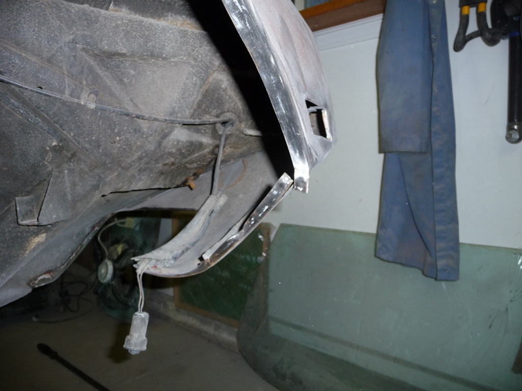

Whomever did the bumper elimination, did a decent job. Too bad his hammer and dolly skills didn't match his welding skills. There was 1/4" thick body filler on the rear panels. Holy cow batman... I had to put on a fresh grinder disk to dig though it.... Sweet
This dent was filled in. Crazy...there is full access behind it...why..why..?
Hopefully I can get it hammered respectability straight before it's all said and done.
All in all..between the layers of paint and gallons of body filler...she's probably 20lbs lighter now. No joke!
Next step will be starting to straighten panels.....

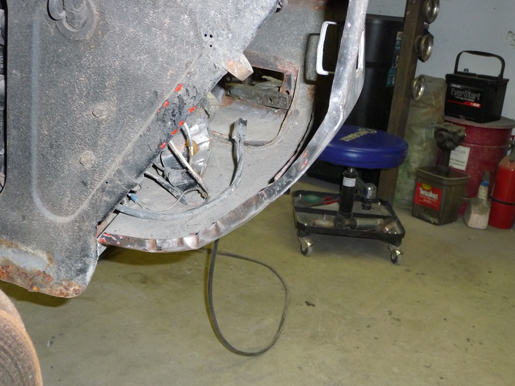

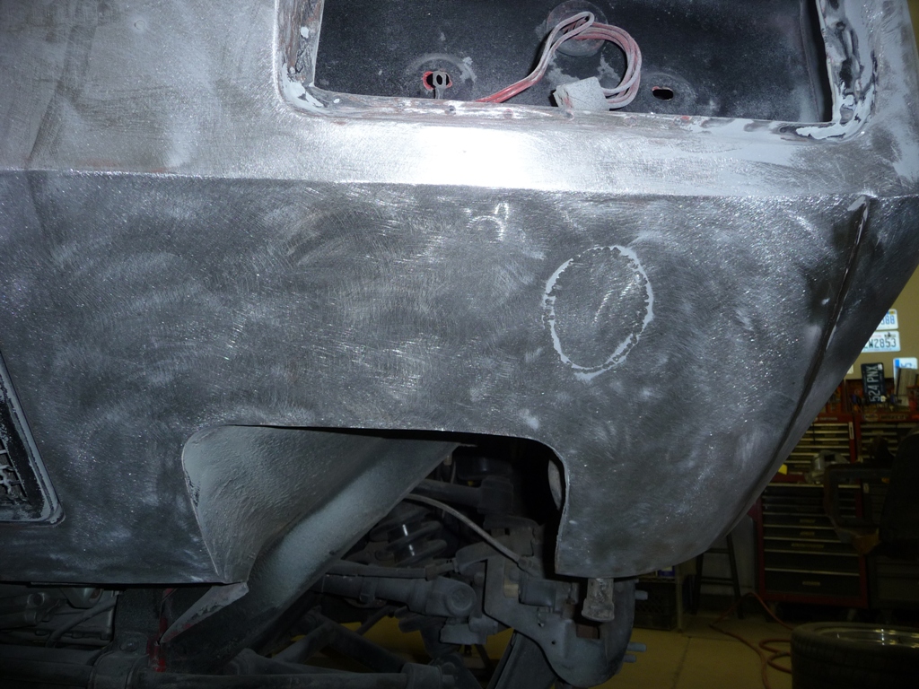

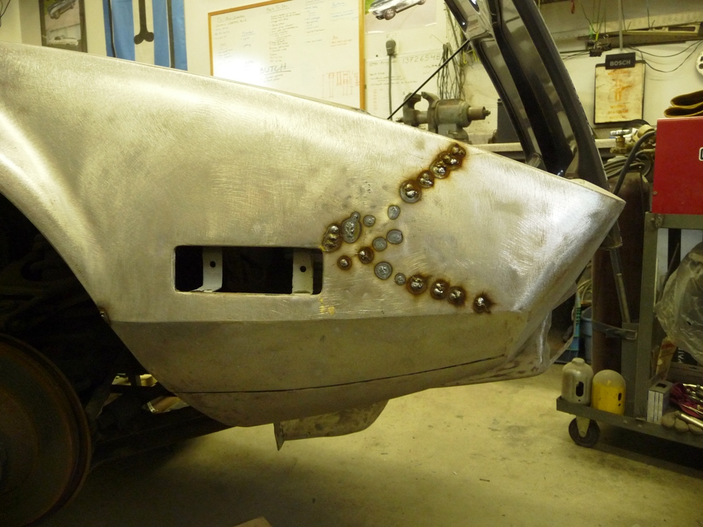

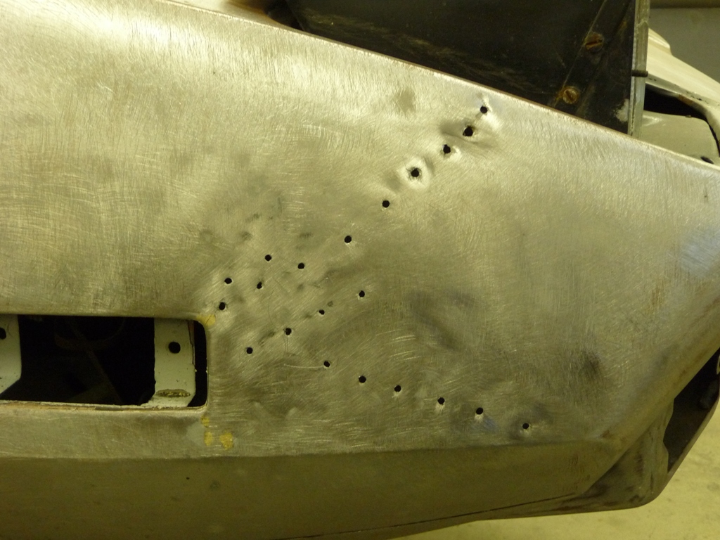

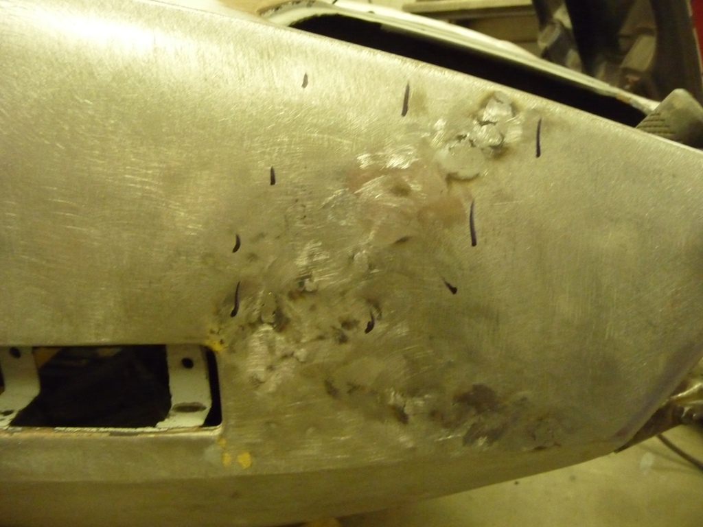

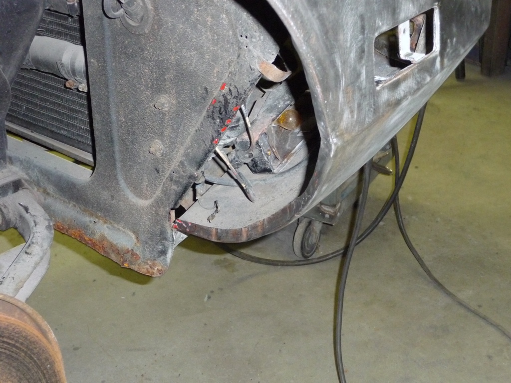

So...started the hammer work on the RF corner today. Got the corner to be pretty close. Had to reshape the wheel opening a bit also. However, forgot to take pics at that....will catch up on that next weekend. Once I got the corner a bit closer, I welded up all the holes from the accident repair I found under all the body filler. Then...spent a bit more time hammering. She's about 90% or so to where I want to get her. The area between the sharpie marks is about 1/16" low still. Next weekend.....
Hi Michael,
I won't profess to be great at it! I'm just stubborn ...and don't like to accept my shortcomings Big Grin . So, I power through and keep at it until I'm happy with it. The Pantera body is thin metal, which sometimes makes it easier to work, however can create its own challenges too (stretching, welding). Patience is the key/and challenge for me.

Very nice work. I am hoping those holes were from the PO, so you don't get mad at me for my comment....
I was thinking the same thing Rocky in regards to the "sliding hammer" & posted suggesting this method/tool...
http://www.autobodytoolmart.co...us-4550-p-16146.aspx
Thanks Rapid. Here are some more for ya... :-)

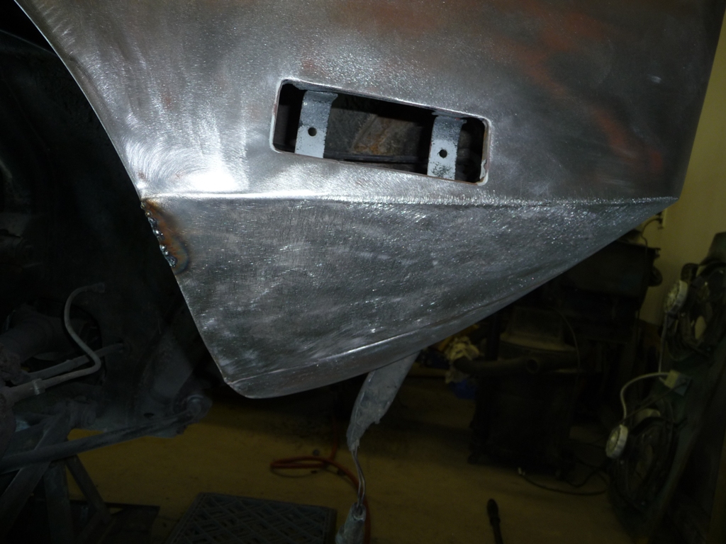

Ok, so took some vacation from work... So, got a bit hammered out today...

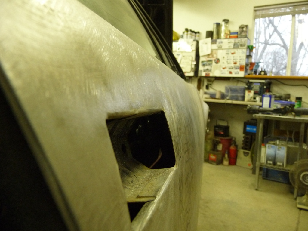

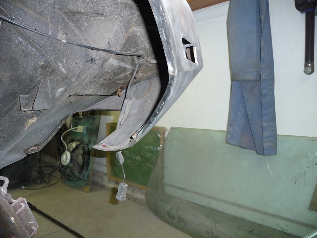

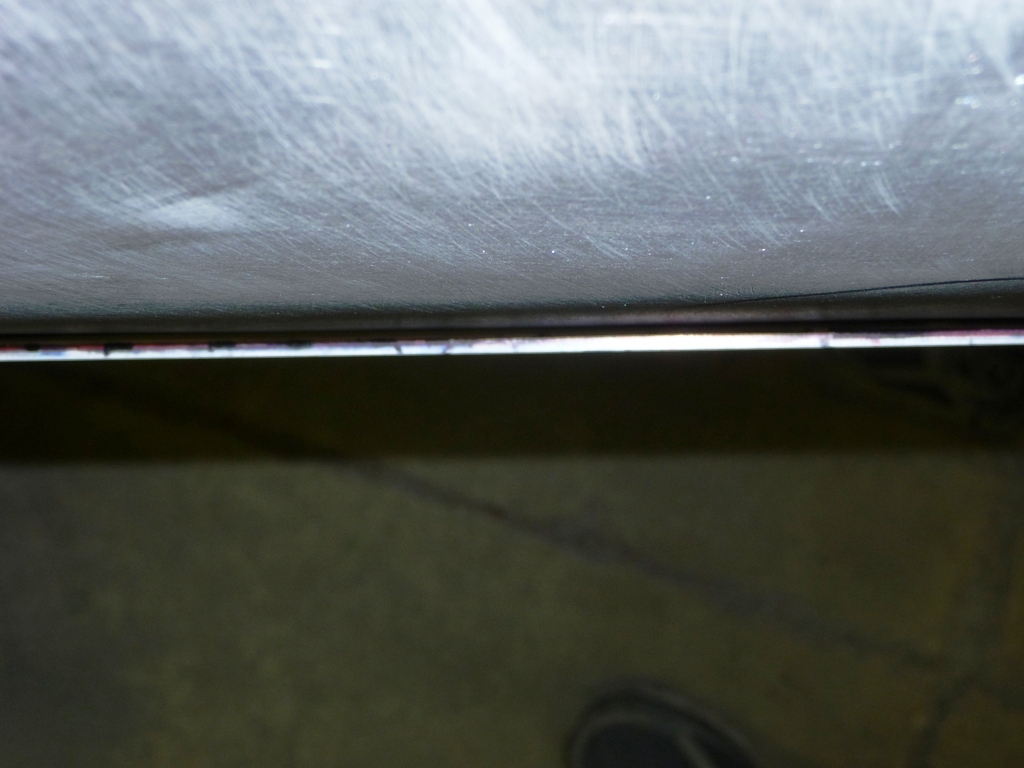

Started the day with the finish shaping of the RF wheel opening which I had done a lot of work to a couple weeks ago. I had the big dent out, but the outer profile of the curve is still quite flat.
I may revisit it later to try and get the ripple in the lip fully out, but I'm happy withe the contour now. The curved profile is now uniform. Getting the metal of the lip to shrink enough to get them out is kinda difficult. Got most out..but the really big ones are "smaller"...but not gone "yet" :-)

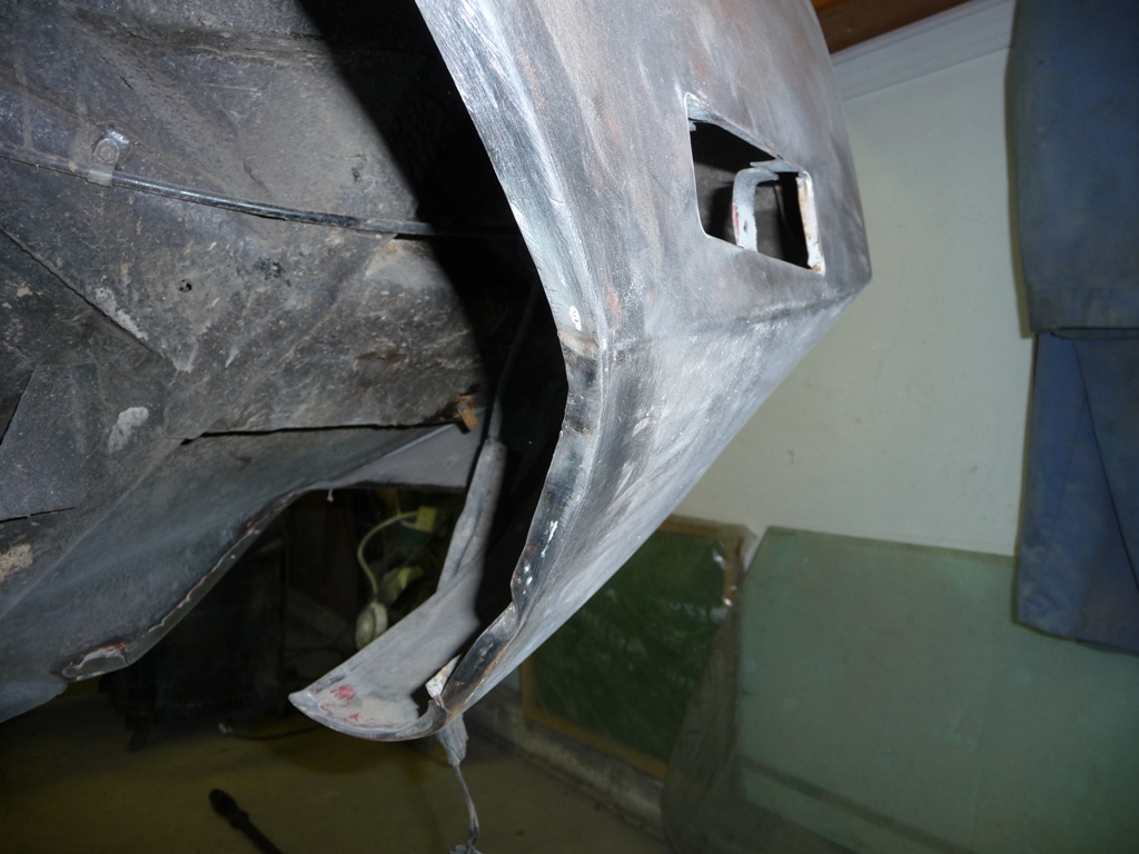

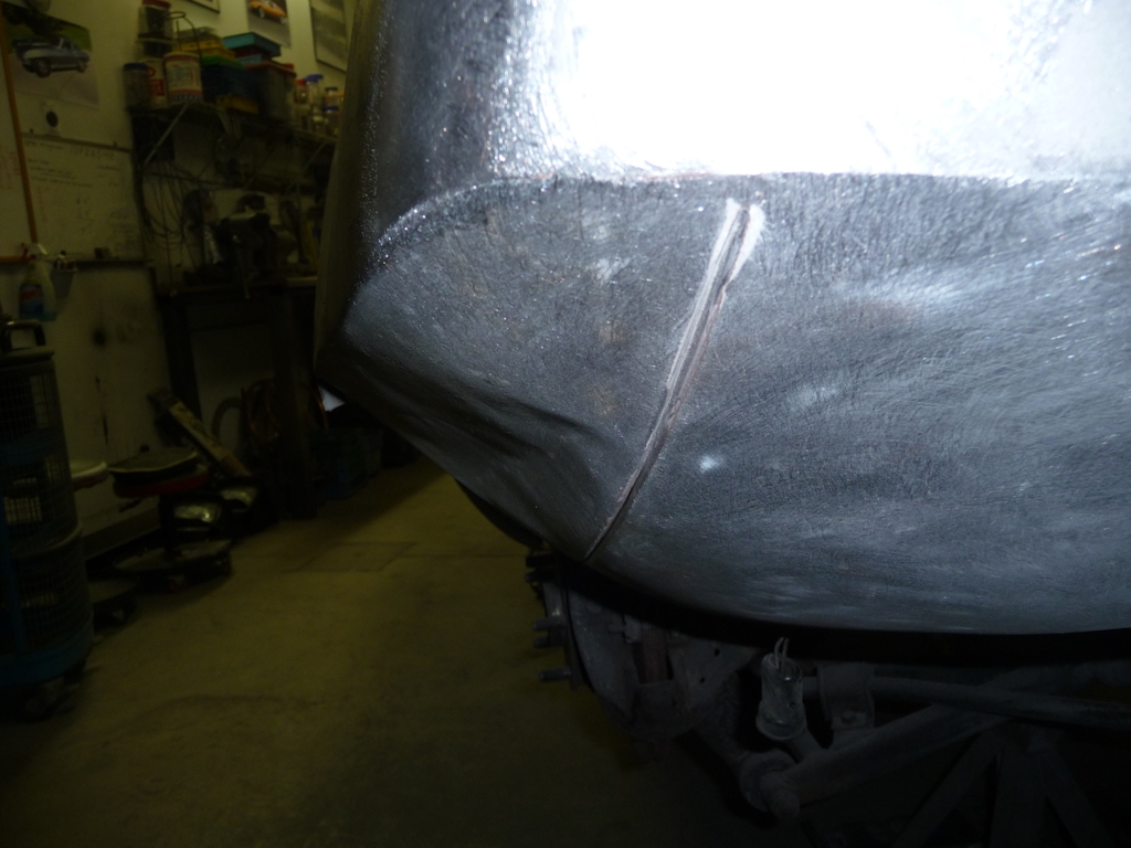

Then moved to the rear and straightened out the rear valence.
Then to the LR to address the caved in rear quarter.
Another hour or so and I should have the LR buttoned up. I'll get on it again in the morning.
