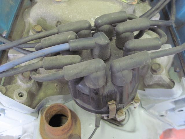

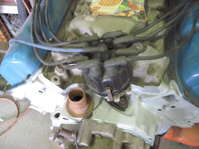

Here's what I need -
What's the trick to routing the wires so that they aren't crossing all over each other?
Or if they must, how do you make it look like they are "supposed to be that way"?
Mine look like crap with all the criss-crossing!

It goes into the water pump (lower silver fitting in the picture with the wires, above).

Rocky, when I loom up a set of custom wires, I imagine the distributor cap as 2 halves, split along a front to back line. This would be where your cap clips are in your photo. Route 4 wires to the left and 4 wires to the right. Take the wires (2 from each side) that have to cross over to the opposite bank, and route them behind the cap. I'll see if I can take a pic.
Can't help you with the pump fitting though.

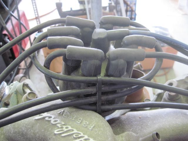

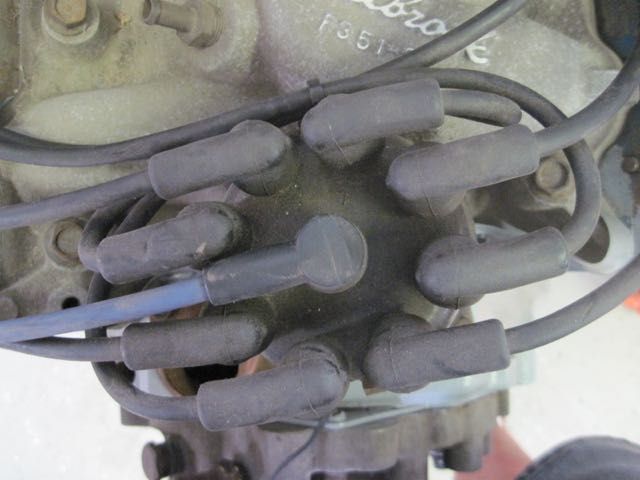

Rocky, here are some pics. I kind of mocked this up on the engine stand; took me a bit to find the box with the dizzy in it.
Rick's post reminded me of something; you can put the dizzy in any way you want by just re-assigning which post is #1. The order doesn't change, just the starting point. Doesn't matter if you have vacuum advance or not.
Think of it this way. The body of the dizzy will only fit in certain ways. It is limited by obstructions, the vacuum can, access to the cap clips, and so on. The cap is keyed to the body, and only fits one way. But the dizzy shaft, rotor, reluctor (or points cam) can fit in many ways. I don't remember how many teeth are on the gear, but it will go in that many ways. I don't know if this will really help with looming the wires. I would think it would cross just as many as it would un-cross, but maybe so. I'd have to play with it and see.
Also, don't get carried away with looming the wires really snug; you can make the cap really difficult to get off.
Thanks, Steve -
Your setup looks good, as does your motor!
Not sure how I missed this for so long.
I like the idea on moving #1... I need to think that through, but it looks like a cleaner setup....
Thanks, all for the ideas!
