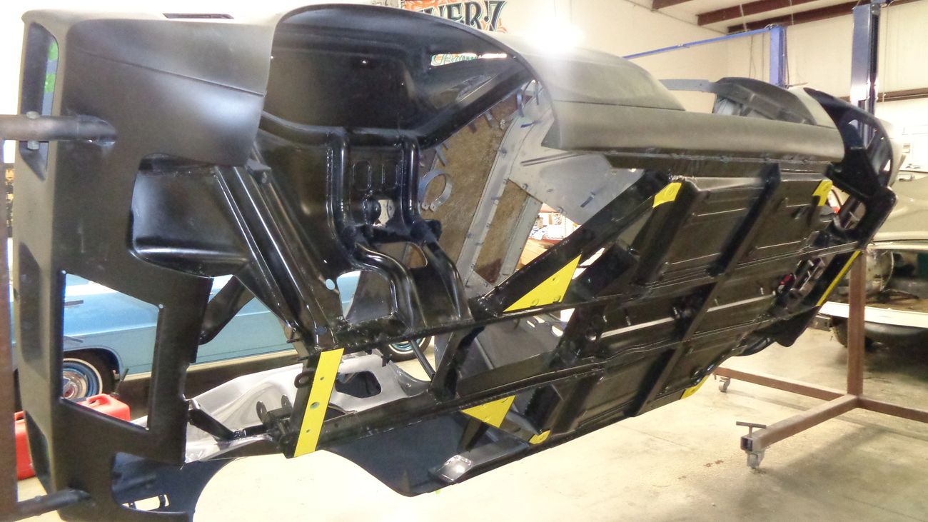

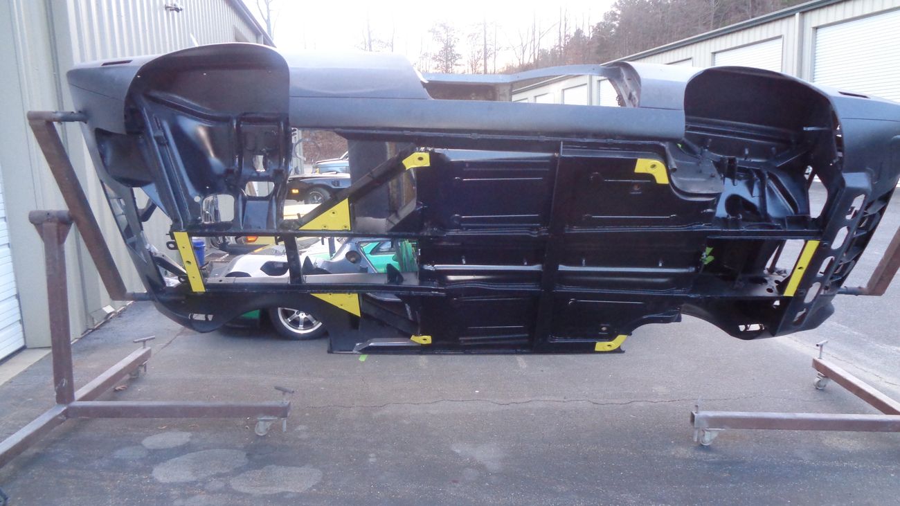

update
the seams have been stitch welded and the "jacking plates" installed
a floor jack plate across the rear cross member (will be drilled in the center for the tire jack peg)
Not sure about the rear post jack arm position under the motor mounts
the center frame tire jack position
the front frame tire and post jack arm position
and added a front frame floor jack position (also will be drilled for tire jack plug)

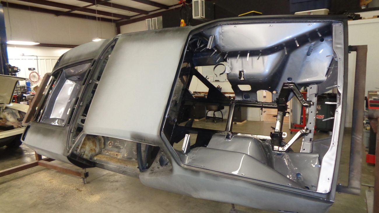

some update pics
